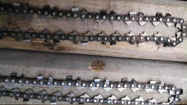

  16. papadave
    Top is the old original Husky 3/8.......
    Bottom is the newer Oregon 3/8.......

    They both look the same pitch to me??? I see one is a 72dl and one 80dl???
    A 3/8 20" chain is 72...but a 18" .325 is also 72dl??

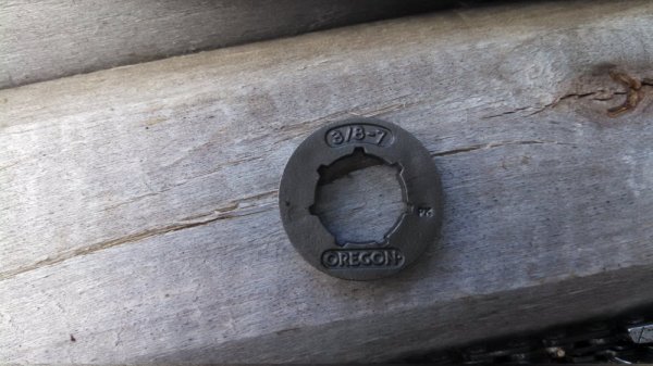

  18. papadave
    This is the sprocket I tried with the newer Oregon chain.

  20. papadave
    These are both 20".
    Yeah, weird that the Oregon is marked 80, but I counted and it's 72....same as the Husky
    They look the same except the rakers.
    ETA: Sorry, the Husky is the one marked 80.
