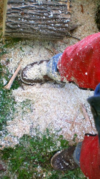

  17. Stinny
    14,138
    60,665
    Couple things Papa D... thanks for the Ibu breakfast thing before bending/lifting. Feel good after this morning. Second, I am still grinning at the difference I see with my 257 after Pete "straightened out" the bad job of sharpening I'd been having done at a local shop. After 3 tanks thru the saw this morning, in oak and ash, here is what the chain was still throwing. All cuts are still straight as an arrow down thru the oak. I'll leave it on for the next cut too.

    I think it was bogeydave that came up with the IBU routine.
    The 18" setup runs great, and throws chips. :thumbs:
