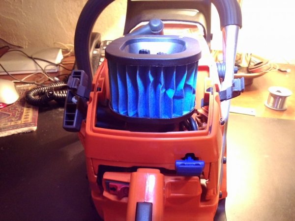

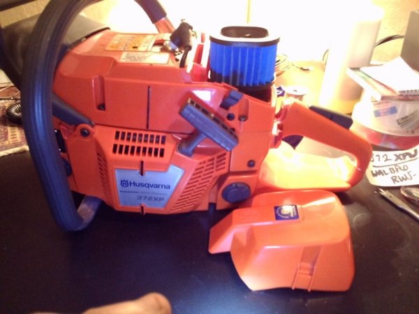

    OK, here is a picture of the RWJ-4-1 setup on a 372XPW. You can see the crimp in the filter material in the second picture. I use the blue paper like filters in the summer because they are cheap, work well and when messed up with spit-back, I pitch them in the trash and use a new one.
    Jon1270 does this answer all your questions?
    You can also see in both pictures the small amount of extra protrusion on the blue XT choke control when using the RWJ-4-1 which is no longer made by Walbro, now made by Tillotson.

    Man, reading all this stuff. I'm still mystified. But that picture speaks volumes. If for no other reason, I'm following this series of threads is the vast amount knowledge & experiences that are being shared. KRL my hats off to you for doing this....:yes:

    Ah, that does make it clear. Thanks.

    World Champion covers? Pics?

    Kevin, you can see the 'World Champion' top cover and starter cover in the first picture. They are made like the raised silver XP that came on the saws a few years back.
