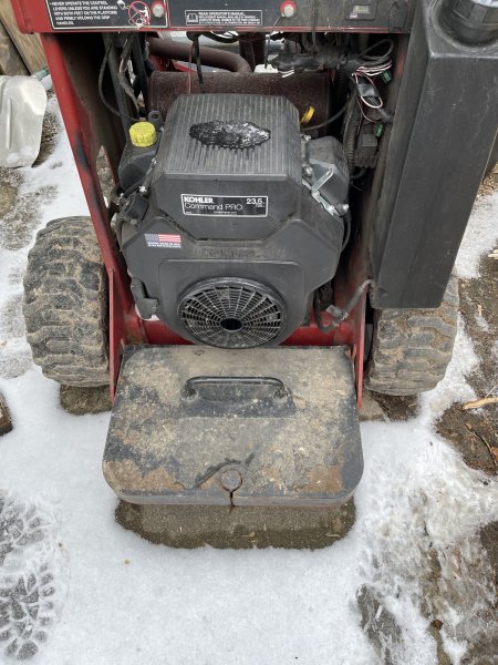

    Keeping it running? This machine has never failed to start/run/mow.
    Its been flawless for 26 years.
    Heck! Its even got the original oil in it!:eek:

    I do sharpen the blades every 5-10
    years

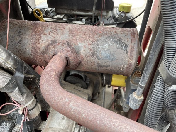

    Looks similar to the muffler on my kohler powered dingo

    I bet you could take the old one off bring it to a muffler shop and they could weld up a new one for you.

    Mine’s repowered with a kohler command pro. The first Kohler only went 650 hours. I have no idea how it was treated though. Probably roughly. These little machines typically lead a very hard life. 6DA220B3-AE9C-4108-B84A-9F95480767E5.jpeg
    When I was going through the repower search I looked for a new muffler. They make several variations of this same muffler. Yours has a side exit and appears to have longer mounting pipes.

    Yep. Same can, different pipe configuration.
    I'm waiting on a reply from Isavetractors. Good chance ima buy a muffler there and adapt it

    Not much to those mufflers. Just find one that's 90% of what you need (size and exit location) and fabricate the rest. If you can bend tube, you can fab the inlet piping easy.

    If the pipes are good yet, just find an automotive small muffler about the right size and weld the pipes in it. I've got a glass pack type muffler here that would be close.
