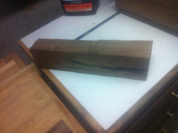

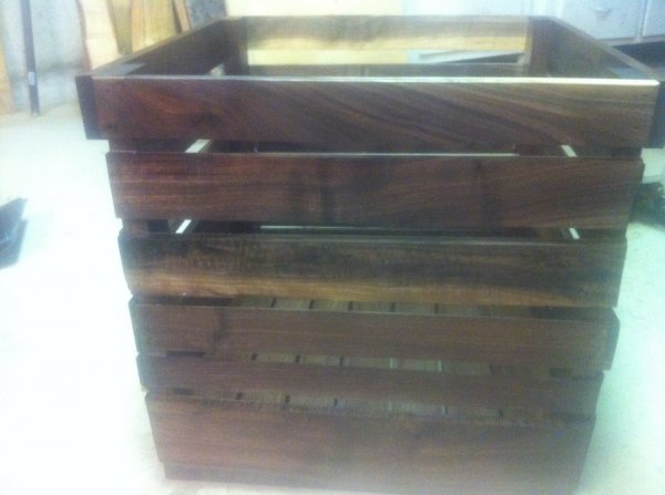

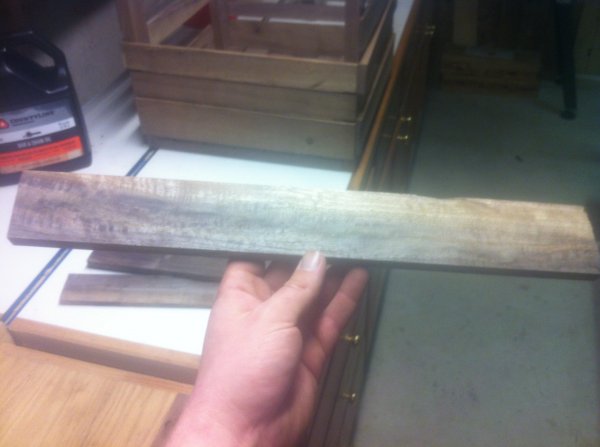

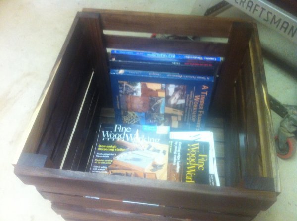

    I'm warning you now, Jeffrey Svoboda - looking inside your firewood can become a real expensive habit. ;) I'm glad I didn't burn this piece though, cause I ended up using it in my sister's birthday present.

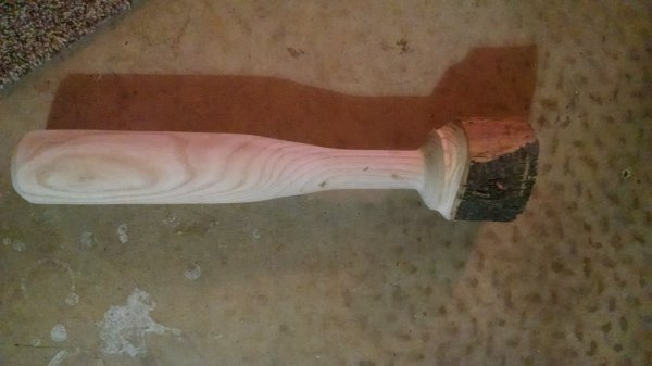

    Well this isn't curly but it is ash. First time turning on the lathe. I ask the girlfriend what she would like. Only thing she could come up with was a bad. So I thought for a sec and realized I had the perfect wood and it was an easy project. Well it was slow going to start but then I sharpened the gouge. Then it went faster. This is what I ended up with tonight. It's not finished but still had to show it off. Lol IMG_20160420_201240141.jpg

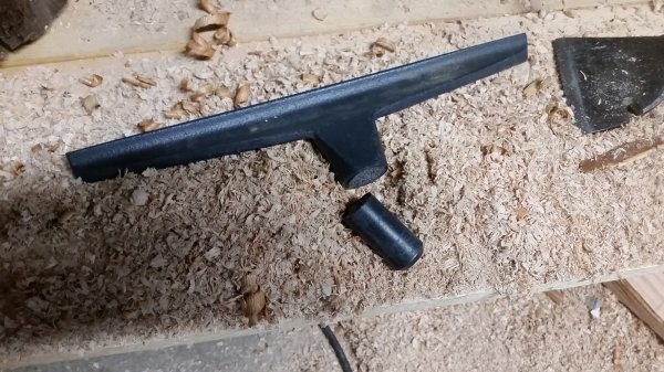

    It sure is a fun hobby. I just built a new stand after having it taken apart for some work in the shop. I went through the lathe completely to make sure there were no worn parts or safety issues. Having a piece of mind on that end let's me focus on the work.
    My tips are have sharp tools, know the tools limits, use safety gear, and no loose clothing. I've had a handful of blocks jump off including one today. I snapped a tool rest last year when a block jumped off the pin. So between the jumping block, the chisel that kicked and the snapped cast iron arm, it was a lot to happen in an instant.

    I had to laugh when I saw the pic because I don't know how many people create the same thing on their firs attempt on the lathe! I did and then I ran into a buddy who works for someone that has a complete workshop (by my standards). Of course, it had a wood lathe also and he admitted to making a bat the first time he used it!

    I made a bat in woodshop class in high school. Does that count, lol! I still have it too.

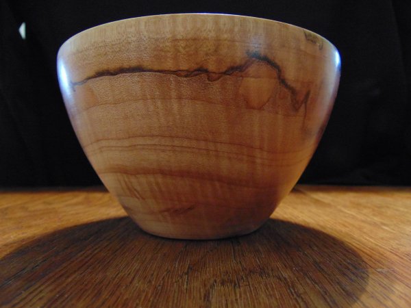

    Do you have a faceplate? I've recently turned my first bowl. Only about 5".

    The Wood Wolverine. File handles were the one thing I forgot!!! Yes I have a faceplate and a chuck. My original plan was to turn bowls for mother's day but figured I'd start simple and see how everything worked out first. I like your bowl. I'm thinking that's the size I'm gonna start out with to. How was it turning and what kinda wood. Was it dry or green? Did you have any tear out? Sry for all the questions.

    Bowls are challenging when you have no experience or anyone to show you how it's done. Remember to "work downhill". Go from the "fat" toward skinny, which is going down grain helping to prevent catches. Check out this explanation:
    I'm finding, as a beginner, having the right tool is key. I do not yet have the right tool but I'm making do and it's not ideal. When I can afford it, I will get a bowl gouge. I did/do get a bit of tear out, but with really sharp tooling and the right technique, I'm learning to minimize it. After roughing out the shape, use a scraper to shave the piece smooth, then going through the rest with sanding, lots of sanding.
    My pieces are very dry, seasoned firewood chunks. That first bowl did develop 2 small cracks, which I filled with sanding dust and wood glue. Lesson learned to not let it sit unfinished(mid project) for a few days. The lathe is @ my dads house and I don't get there every day. The wood moves and gets out of round pretty quick.
