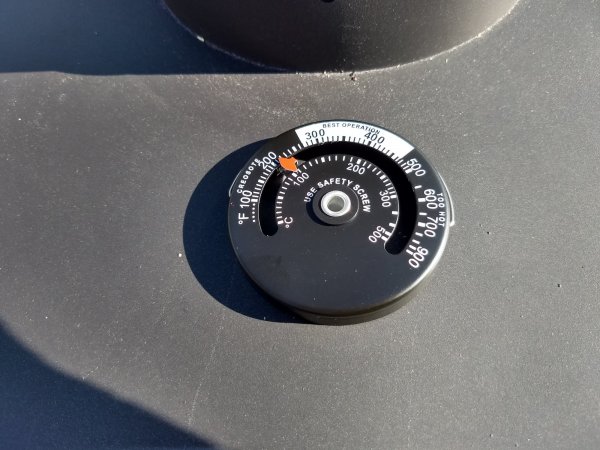

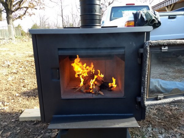

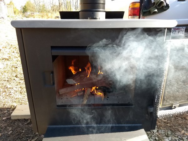

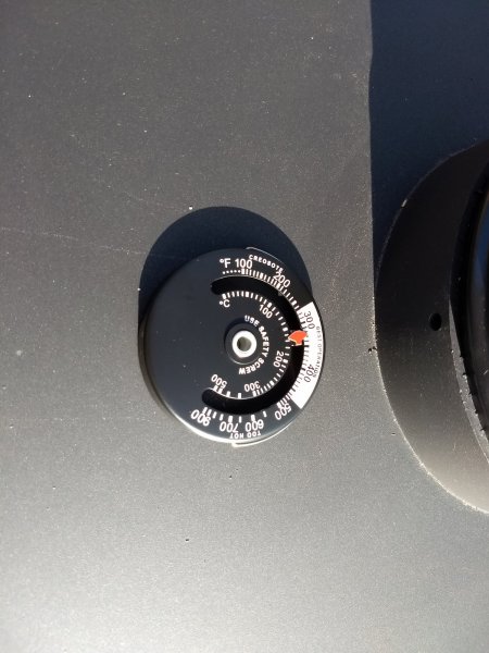

    Update! Finally got the first burn in the new TN20. Outside and very little draft. It's been a warm day around 56. Here are a few pics. We warmed it up to 200 first, let it cool down some and then put more kindeling in to get it to 350.
    All with an open door, the 4' pipe just didn't give enough draft. I tried to get some pics of the smoke coming from the chimney and showing the fire inside the stove. However. the sun was rather bright and it didn't work.
    First the fire starter. Next put some very dry kindling over it and set it on fire. Lit great no problem there but had to leave the door open and it started smoking. It took a while until the pipe got warm enough to draw.
    Added more kindeling and it started to burn better but only with open door. The back started to burn off chemical odor. The smoke isn't very clear on the pics. When it got just over 300 I closed the door and did some other chores.
    Had to put it under the porch in case of rain tonight. Hopefully we can do another burn tomorrow.
