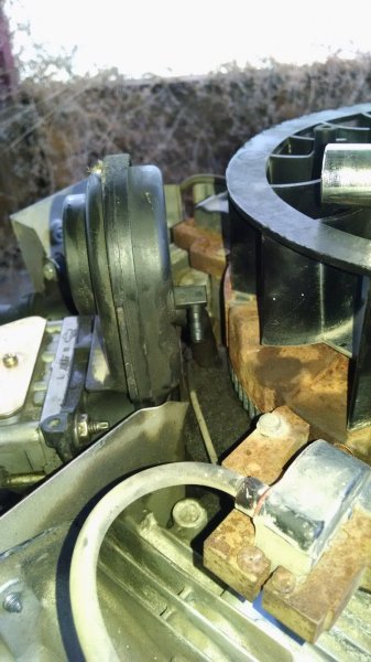

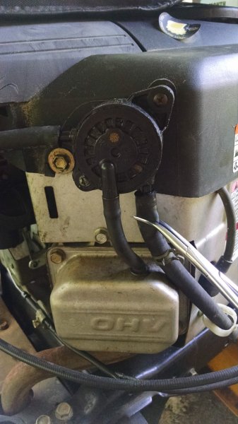

    There is a vacuum nipple on the backside of the air intake, but no line attached, no cap to plug it off, and for the life of me I can see no other vacuum ports.
    Should this be??
    In my experience, if there's a vacuum nipple, there should be a line attached.
    Vacuum line to the vacuum-run fuel pump is not clipped in any way, once again, vacuum leaks cause many problems.

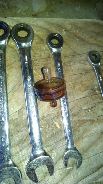

    Finally, a look at the fuel filter, you can imagine the gas that was drained.
    :picard:
    It was dark enough to resemble oil.
    :doh:
