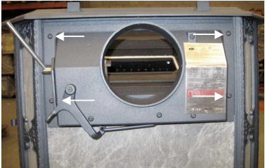

    Now you have my attention. I was not aware the Fireview had a port for a cat probe. Is the port where the upper right arrow starts in the picture below?
    I just spoke with Condar and they have a couple 9 inch probes in stock. The model number is 3cx-9 cost is $25 and shipping/handling is $4.50. I needed an 8 inch probe for my old hearthstone and called Condar for that and found they have other models not listed on their website.
    The placement of the probe certainly is not optimal if that is indeed the cat probe port.

    Actually, the port is at the left end of the upper right arrow, with a cap screw in the hole...hex wrench needed.
    Whoa, I'll be all over that. 9" should reach over the edge of the cat by maybe a half inch...perfect. Thanks, HM! Wish I had thought of calling them a couple years ago... :picard:

    The problem is it doesn't react much. Mine just sits there at 1000 or so when ramping up the stove for a light off, then doesn't do much after I close the bypass and light the cat. Guys who have put in a thermocouple or drilled for a probe see temps of 1400 or so. I actually get a better indication if the cat is lit by watching for a relatively fast rise on a stove top meter placed over the cat. On my Dutchwest, with the probe tip over the cat, I can see a rise of 100 every minute or two when the cat lights. Then again, you don't even need a cat probe; You can tell by looking for a glowing cat. But the probe is a good indicator what's going on later in the burn after the cat quits glowing, but is still burning.
