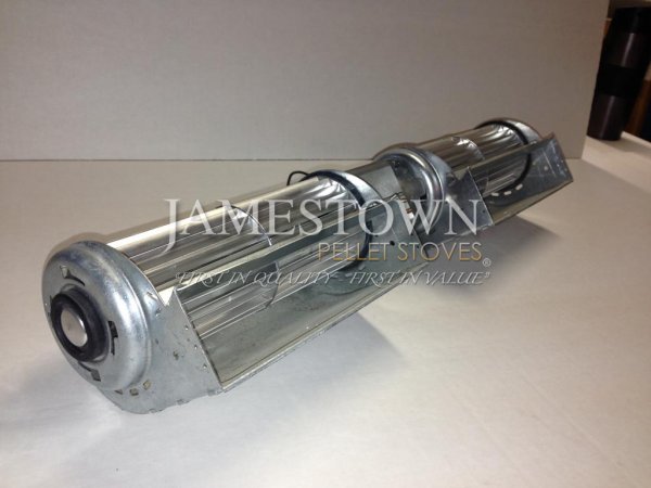

    My crossflow fan in my stove is squealing at certain speeds. It's the 2nd one I put in since owning the stove for 3 years, this one is less than a year old. Jamestown doesn't have any plans to get any new motors in since I am the only one that needs one at the moment, and I know they have to buy a lot of 50 at a time. There is no oil ports on this fan, and I have removed some bearings and oiled but it didn't help. They sent me a fan that is used in the older model J-1000's but it was very under powered and barely blew out any heat. Can anyone help with cross referencing this fan for me or pointing me in the right direction of an aftermarket part I can buy. Thanks

    Got a pic of the motor tag? Looks a lot like the jakel in my avalon. Was difficult to cross reference...

    Welcome to the site Mike! I've found that just a dab of graphite or machine oil on the bronze bearings on the rotating shafts once a year does wonders for these motors....I also blow all of the dust out of them with compressed air every spring and sometimes in the middle of winter as well. Keep most of the squeaks at bay and makes them much quieter. Check with others on your specific stove first though.

    Those brushless motors are pretty much fail proof when you clean and lube them once in a while. Also when lint and dust get built up on the "squirrel cage" (fan), that can throw it out of balance resulting in a squeak.

    Ok, I took the fan out cleaned the dust off and lubed the bearings best I could. Put it back in and about an hour in I heard it start squealing again. Shut it down, and sprayed some more lube on the bearings. Ran it all night and didn't hear anything. That's good, but now there isn't a difference in fan speed between 3,4,and 5. I can actually live with no squealing and the fan speed on 3 until I hear from Jamestown about a new blower.
