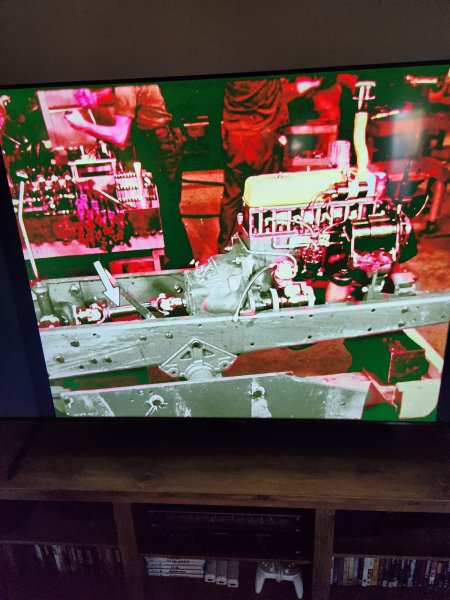

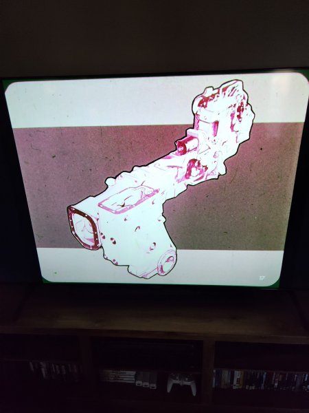

    Wrap your noggin around this. This is a demo "differential steering" unit dealers had to show how the Oliver steering worked vs its competition. Never decoupling a track has big advantage in traction and safety if pulling heavy loads down hill or side hilling. Traditional crawlers have a clutch for each track then a brake for each track.

    Now, I'm an extremely mechanically inclined type of individual. Since I was a kid. That drawing above.....nope. Can't get my head around it.

    It has a drawback. They can't turn as sharp as the other style that could turn around in its length vs a three point turn to turn around.

    It's funny though...im watching that video I screenshotted on the case 310..they just got to the steering. It's exactly the the same ..just as you said. Same picture of the diff and everything ! You should check it out !
