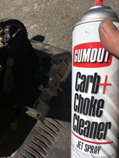

    It is a 2003 dark green craftsman 22" push mower.
    1. I drained the gas before storag so I put in fresh has.
    2. Checked the choke lever for proper operation.
    3. Replaced the air filter
    4. Replaced the spark plug
    5. Checked the automatic choke to see if lever moves.
    Still no starting but sounds like it is getting fuel and spark.
    Finally, I removed the air filter and sprayed Gumoit Brand carb & choke cleaner into the carborator.
    It started right up with one pull and is fine now!
    So what was wrong? What did that spray do???

    The carb and lines were probably empty of fuel. The carb cleaner made it get some sort of fuel, and the carb took over after it popped.:yes:
    Will it restart easily now with no "jet fuel"?
