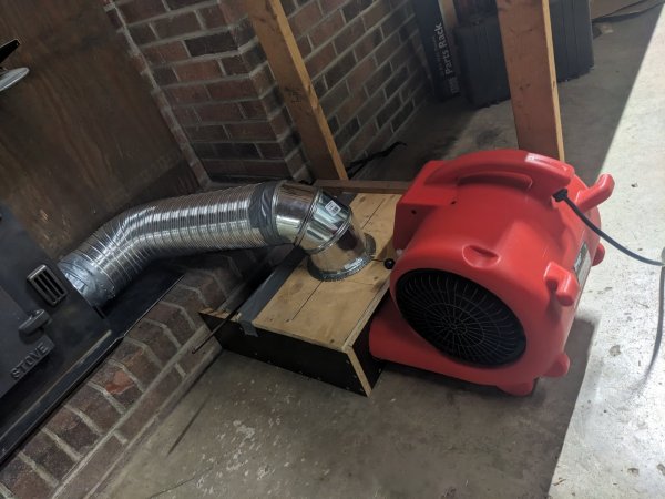

    Im using a 3 speed HF blower to move the air around the stove and up to the upstairs ductwork.
    I built a box to mate the blower to the intake ductwork. The setup in these pics is temporary untill I can run some more intake ductwork back up the other side and around the corner into the "laundry room" portion of the basement. I will build a large wooden box to house the blower. The box will have openings on each side utilizing regular HVAC square filters to keep the fan clean.
    The heater in this house has not been on 1 time since I started using this setup about 2 weeks ago.
    One (1) 110V fan keeps the whole upstairs and basement between 67° and 71° depending on how hard I fire the stove.

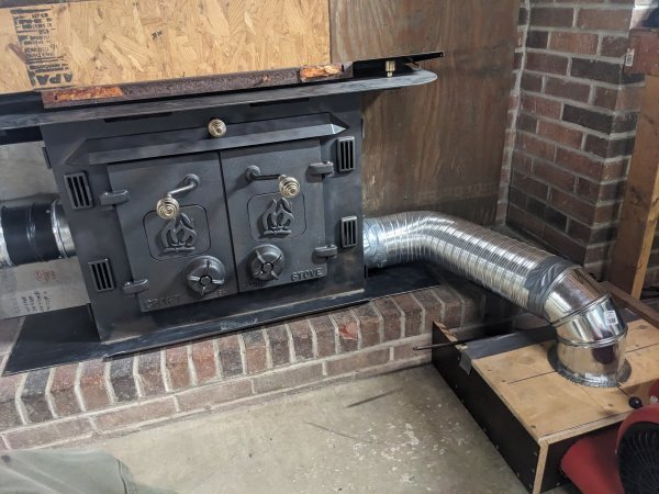

    Looks like it ought to make some heat!
    Just FYI, that black adjustable elbow on the liner there won't last too long...might wanna order a SS one so you have it there when its needed.
    Also, what's the OSB above the stove about? I assume just blocking cold air from the chimney when the stove is off?

    Ordered a SS elbow and put it on the shelf so I'll have it ready if the current elbow gets sketchy.
    Yes, the OSB is a temporary air block when the stove is inactive.
    I will fab a steel wall panel soon. I might have enough Stainless Steel sheet on hand to fab one. I'll have to check my surplus material rack.
    This stove definately puts out some heat on a steady diet of white & red oak. The blower system heats the 1400 sq. foot basement and the upstairs portion of the house pretty well.

    Is the warm air duct from the stove to existing home ducting insulated by chance? If not it could be possibly? A thought.
    Keep up this thread if you have additional info to share.

    Thanks!! Every bit of this project was a one man project. I had no additional help labor wise.
    No insulation at this time. It gives off heat in the basement. The house ductwork is not insulated, it just radiates heat in the basement as well.

    Can that osb catch fire?
    Hashknife likes this.
  10. Hashknife
    Hashknife
    Dec 15, 2023
    96
    545
    South Carolina
    No
    Go up about 6 posts and see my post from Friday @ 10:45am for details
