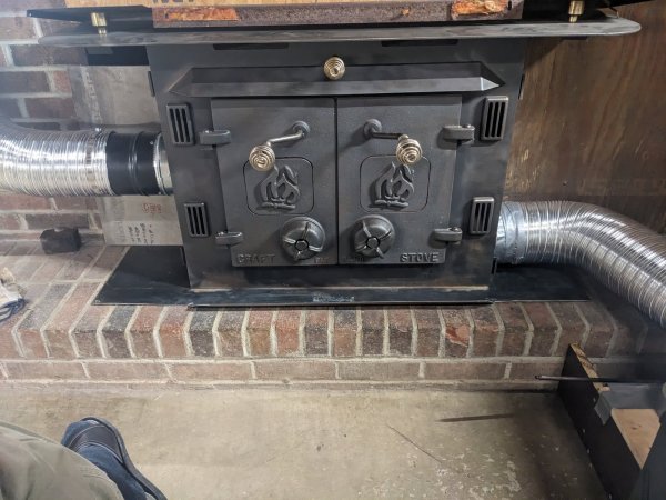

    You're about ready for fire in the hole.
  2. The Wood Wolverine
    19,022
    122,962
    Will you be wrapping that w/ insulation?

  4. Hashknife
    Hashknife
    Dec 15, 2023
    96
    545
    South Carolina
    Getting closer!
    Still have to sweep the chimney out and cut the damper frame for clearance.

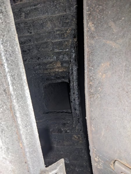

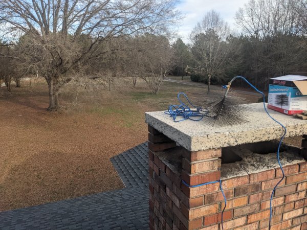

    Cleaning the chimney flue today...
  6. Locust Post
    8,972
    52,692
    Doesn't look like the easiest chimney to put a liner in.

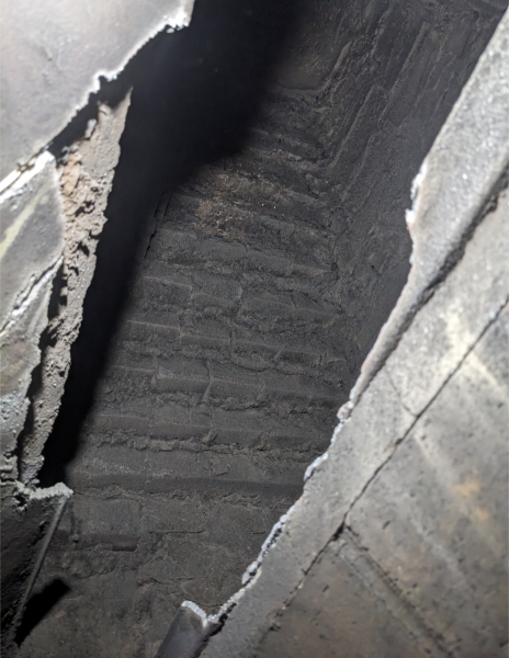

    Sweeping out the smoke chamber
  8. Hashknife
    Hashknife
    Dec 15, 2023
    96
    545
    South Carolina
    It has not been too bad so far. As long as the weather cooperates, it goes pretty fast.

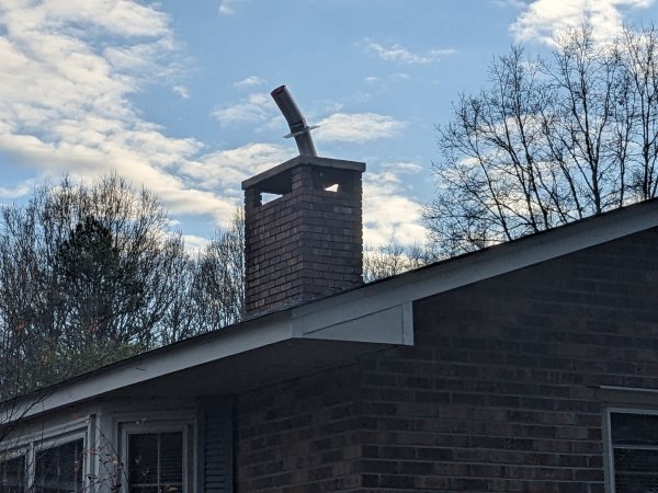

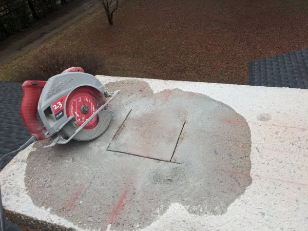

    Im going to cut a square "hole" in the concrete chimney cap and drop the liner down.
    brenndatomu, wildwest and Locust Post like this.
  9. Locust Post
    8,972
    52,692
    I wondered if you could work the top loose and lift it off.
    wildwest, Hashknife and brenndatomu like this.

  11. Hashknife
    Hashknife
    Dec 15, 2023
    96
    545
    South Carolina
    The top is lag bolted to the support columns. Its pretty solid.
    Even if I could get it loose, I don't think I could lift/move it. Its got steel framework in the concrete for support. It is heavy as hell!
    There is not enough clearance between the flue exit and the concrete cap to install the chimney cap assembly correctly.
    I'll layout and mark an 8" square on the top of the concrete cap and cut it out with a skill saw

  13. Hashknife
    Hashknife
    Dec 15, 2023
    96
    545
    South Carolina

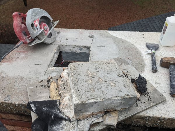

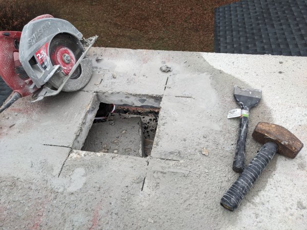

    Cut the hole in the concrete cap today.
  14. Hashknife
    Hashknife
    Dec 15, 2023
    96
    545
    South Carolina
    Down the chimney with the 25' liner.
    Got to trim it to length and install the top cap
    RGrant, Softwood, Locust Post and 2 others like this.

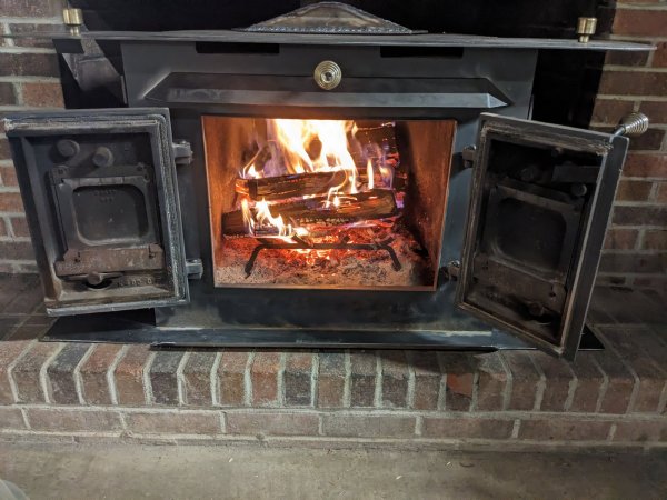

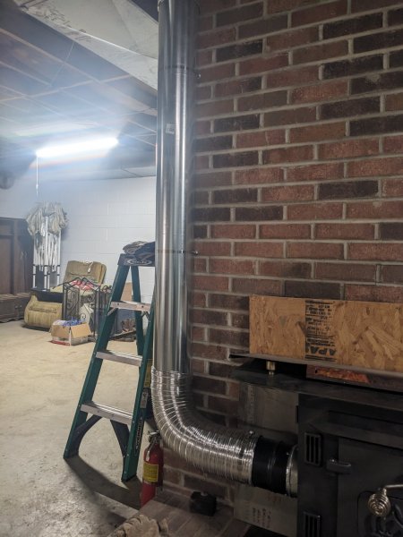

  18. Hashknife
    Hashknife
    Dec 15, 2023
    96
    545
    South Carolina

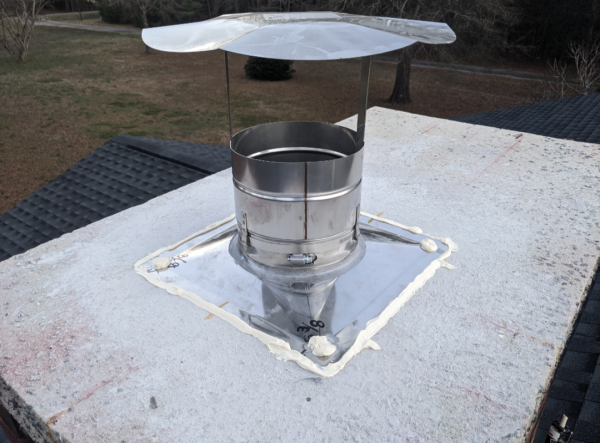

    Got the top cap installed.
    Also got the liner hooked up to the stack transition. Not much room for me to work in there! I could barely get in there to get it hooked up. Once it was hooked up, I had to go back in with the cordless drill and drill some 1/16th diameter screw starter holes for the screws than mechanically fasten the "elbow" to the transition stack.

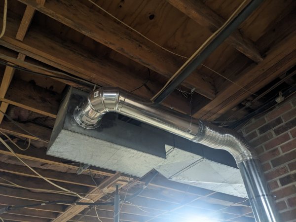

  20. Hashknife
    Hashknife
    Dec 15, 2023
    96
    545
    South Carolina
    Finished the 6" duct work to channel hot air into the upstairs ductwork. It keeps the upstairs around 68°- 70° so far
