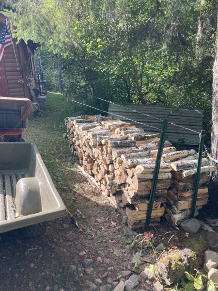

    I just stacked and top covered this birch last week. It will be ready to go for next winter. It woud really bother me to leave it like this through winter/spring 2022, and if I did, it would probably not be ready burn to my standards by the end of 2022.

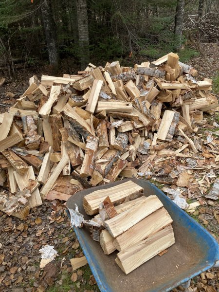

    When weather is favorable, I may take off my top cover for a good long spell during the spring or summer time. I use metal roofing on this pile of poplar and ash that was cut this past April, and is now burning great.
