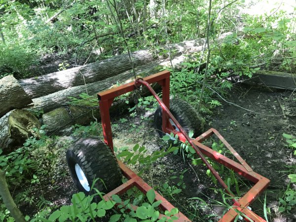

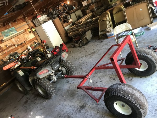

    Well I've put a couple miles on this thing this weekend and I gotta say, it's awesome!! :dex: :quad:
    It actually works better dragging bigger or longer logs - the extra drag helps to lift it to the top of the bar right away. Under about 6' you really have to keep your speed up to keep it off the ground.
    I'm really getting a system down now. Park the quad near the logs, bring the chain and cant hook on the first hike and get the log choked. Closed side of the hook in direction of pull. Wheelbarrow the arch over and hook onto the log. Back up the quad, hitch up, and drive it out to the yard. Drop the log, unhook the trailer, pull forward, use cant hook to roll it out of the way. Repeat as often as necessary. :D :quad:
    Most of the time, the log is not in the right position where you can hook up tight and go. So what you can do is line up the arch the way you need to go, hitch up the log and drag it a little until it straightens out, then back up over it with the arch and hitch it tight.

    I'm not sure, but the tires on the log arch look like they have too much air in them.
    They appear to be really bulged out in the center. Better give them a check, Shawn :yes:

    Well you were absolutely right Tim! The one tire maxed out my gauge! I bled them down to 20. Thanks brother! :handshake:
