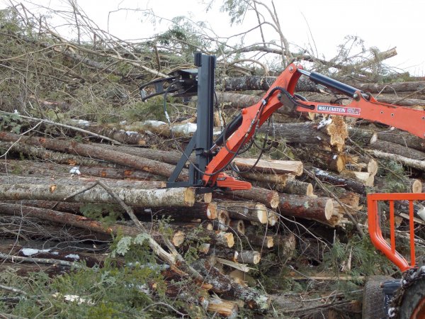

    Oh here are some updated photos of the Feller-Buncher. Definitely making some serious progress with the design, and is far more productive than I anticipated! :)
    The first one is in the upright position, as if it was felling a tree, and then of course the second is of it laying that tree down into a pile, or onto a trailer.
  6. clemsonfor
    clemsonfor
    15,996
    37,478
    Greenwood county SC
    So I guess how you are working it, is you grab the tree pivot the saw into it and then away and hen lift up the tree?
  7. LodgedTree
    LodgedTree
    Aug 24, 2016
    2,371
    9,428
    Maine
    Yeah that is how I do it. It gets a little goofy because if they are tall, I have to saw them off as high as I can first. That allows me to cut the tree into two so that I can have shorter lengths on my log trailer.

    I think this would be a great application for a power saw that I. Really did not like to run !
    How do you advance the throttle ??
    clemsonfor likes this.
  11. Cold Trigger Finger
    Cold Trigger Finger
    Oct 4, 2017
    2,866
    17,366
    Easern Central Alaska
    This just begs for a you tube vid !
    My hats off to you!! Very impressive !
  12. LodgedTree
    LodgedTree
    Aug 24, 2016
    2,371
    9,428
    Maine
    I fabricated a lever that bolts to the saw frame, but when an attached cable is pulled, swings into the throttle and takes the saw from idle to full throttle. That has a spring attached to it that keeps it pulled back (unhooked in the photo which has a black arrow pointing to it). I still have to route the cable, however that is difficult because of all the movement of the boom, swinging, and pivoting of the feller-buncher head itself. That is a lot of movement to account for.
    I also have to put a long spring on my hydraulic hoses to keep them pulled back and out of the way.

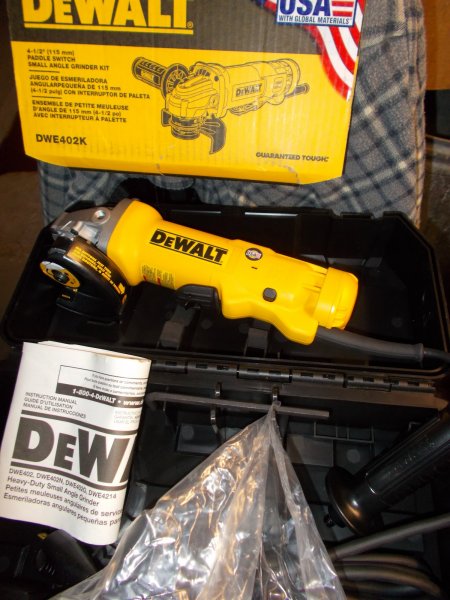

  13. yooperdave
    35,950
    226,263
  14. Pallet Pete
    Pallet Pete Moderator
    13,483
    54,125
    Ovid
    yooperdave and clemsonfor like this.
  15. Cold Trigger Finger
    Cold Trigger Finger
    Oct 4, 2017
    2,866
    17,366
    Ohhh , nice and shiny !! Nice ! I like the switch and lock on it .
