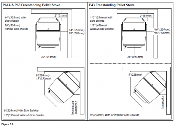

    How close can I stack pellets to the stove? What are the clearances on a pellet stove?

    It depends on the stove and you would need to consult the install manual for the ones you are considering. Here is the info from a manual I downloaded for the P-series Harmans 7/20/18. That the smaller clearances are for a stove with separate side shields. I have side shields on my P43, but don't need them for my P61a in the basement. And, it isn't clear, but those clearances are to combustibles, not just to sheet rock walls.

    The side clearances on a Harman P-Series are greater than most stoves because the sides and top get very hot. :)
