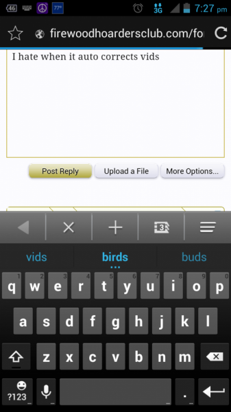

    Birds? Whatcha do in lookin at birds :)

    Screenshot_2014-08-02-19-27-34.png It auto corrects vids to birds , I forgot about that. I was reading as I was typing saw I types out right and went on and never noticed that it auto corrected it to birds. Need to save vids ....see the suggested word on screen capture that it corrects it too when I space.
