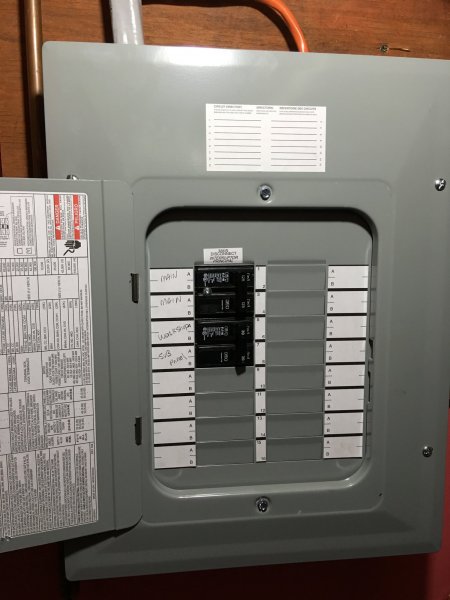

    A pellet boiler also heats DHW too which is nice but in our area the electric rates are fairly low and the ECO Smart instant hot water panel is inexpensive. So I just put in a 125 amp sub panel next to the Super-Stor so an EcoSmart 18 would be easy to pop in.
    Luckily the tap water mineral content is very low.
    See my neighbor's install.
    ECO Smart ECO-18 Instant & Efficient Electric Hot Water System Installation pics-Good & Efficient??? | Firewood Hoarders Club
    Adding an array of solar panels could then give free hot water. :)
    See New panel pic below:

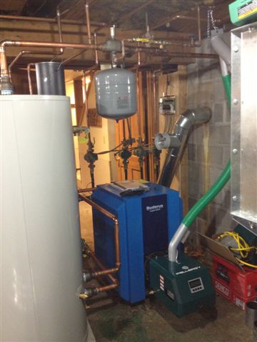

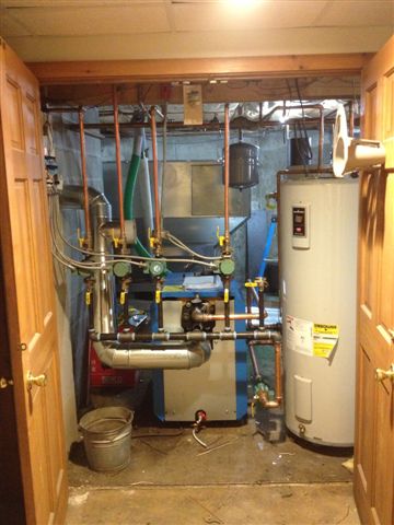

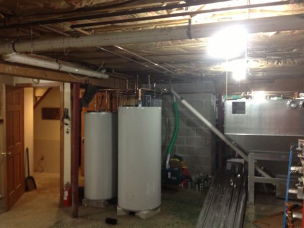

  8. jtakeman
    12,310
    55,496
    A friend of mine has a buddy with a boiler conversion in NH. From what he states its a pellet hog and a tight 1600 sqft ranch house. used almost 10 tons last season and almost 8 the season before. He's used 6 so far this season. Its also doing all his hot water IIRC. His previous worst season with oil was 875 gallons. Approx 11.6 tons using the 1.5 gallons per bag rate(not sure how accurate that is??).. Not sure that worked in his favor with the price of oil this season. $249/ton compared to $1.80 a gallon..........
    Tough for me to by in as I haven't used 5 tons even last season with a bigger shack thats kind of loose compared to his. Granted my climate is milder, But its not 5 tons worth milder. Nor would I expect to use that much tonnage to heat the hot water. Anyway, Here a couple a pics of his install!!
