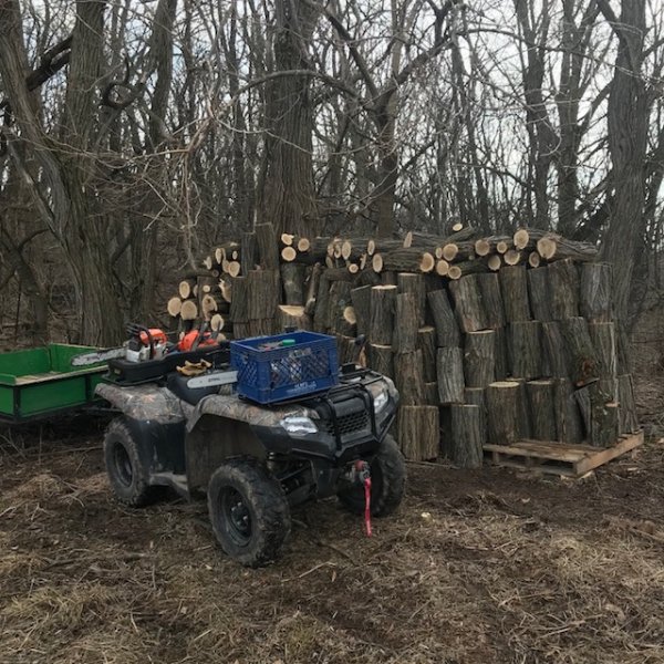

    Spent two lovely afternoons cutting her black locust.

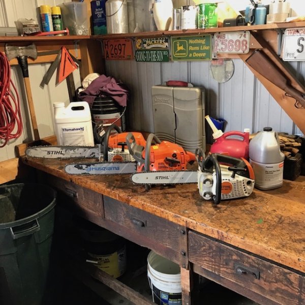

    Now I gotz 3 chains to sharpen and 3 air filters brush off.
    Got a nice jag stacked on pallets. I have not even put a dent in her two acre project. At least the DNR guy will see I have started,,,
    I just can't get used to my son's Husky but I am trying to like it.

    That's how it is when your using a cut-rate saw...:whistle:

    I love the trailer for the atv. Did it have narrow tires, or wider snowmobile trailer tires? Looks a little smooshy out there.
    I need to get back out in the woods. I however don't have a good wheeled trailer option to tow behind the ATV. The only option I have is the 4x8 trailer which is a bit too large for tight quarters.

    it has skinny tires but I am only sinking in about two inches
    the ground was froze yesterday today it got lil greasy
    I approach the locust grove from a CRP field so it's not like I am ripping up her crop field

    wonder what the weight limit is on my trailer
    I may have overloaded it

    Well.....it is spring weight limits, no? :cool:
    Guess it depends on if you lose any rounds or not!
    I'm assuming that is the nasty locust stuff?

    yep all locust
    no thorns have been spotted yet these are older trees
    in my exp young black locust is very thorny

    Man, I wish I had your problem. Those trees are much bigger than I interpreted from your earlier posts. I i figured it was just a bunch of little brushy locusts mixed in with a forest of oak. That looks like solid mature BL.
    Good thing about that stuff is that, properly stacked and kept dry, it will last for decades until you are ready to burn it.

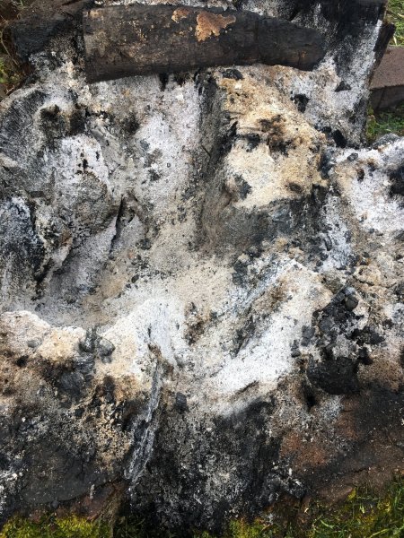

    Big frickn BL stump. That was a solid burn last night. That fire looks like it either ate through to the ground. Mifht have also been rotting there so no wonder it’s so deep.
    We decided (my lady and I) to burn out her stumps one at a time. She has two large 4 ish feet across and a couple small ones at 10 inches so once the stumps burn out, we’re gonna just dig up roots and then call it good. Hopefully that stops it from sprouting so many suckers up. We went this route as some of you posted that Tryclopyr will kill it dead. Despite the invasive nature of Black Locust, the flowers are quite nice and the canopy is sweet in the summer time.
    She still has a few up so we will try this one as a safer solution rather than to kill them all.

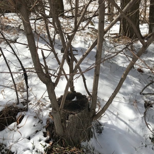

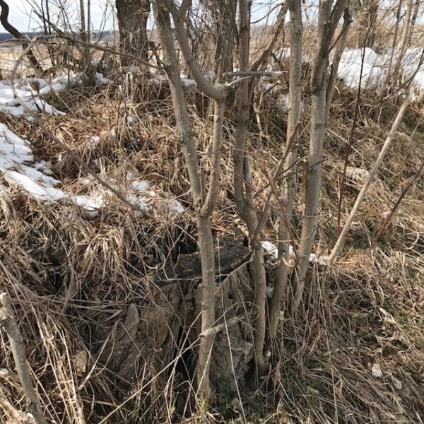

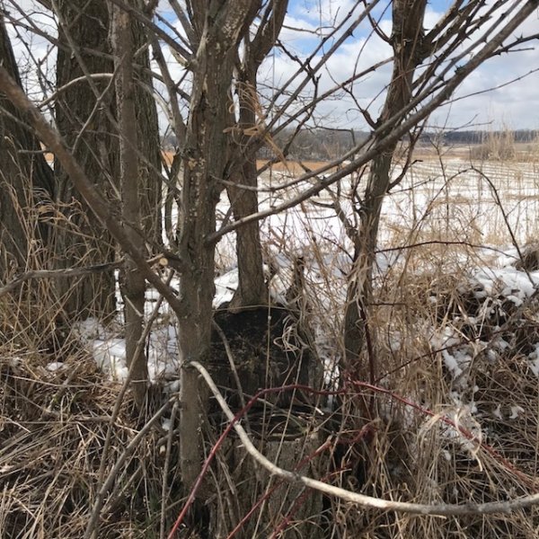

    Come and get some Jon! We got all kinds of these beauties growing along the roads. About 3 years ago the County Highway Dept cut all the black locusts that were getting to close to the roadway on about a mile and a half of the county road I live on.
    I asked the crew doing the cutting why don't you guys spray the stumps? Their answer was "job security - we get to come back every 5 years and do it again" :rofl: :lol:
    Just my opinion but I don't see any beauty here at all?
    They suck back like crazy when the stump is untreated.

    Nothing pretty about that there!

    Agreed. There's a few like that along my road. The beauty to me is simply the self-regeneration - an endless source of wood - although it might take a couple decades to be useful again. Coppice forestry is a very common thing in the UK and in permaculture and we do not practice it to any significant extent here in North America, mostly because we want large trees and do not effectively process the little stuff.
    In my limited experience with live black locust trees, I have found that they tend not to regenerate if the stump is cut as close to flush with the ground surface as possible. I dropped a half dozen of them about five years ago, all live trees, and not one of them came back from the stump. I do, however, have seedlings and sprouts all over the area that they used to be - possibly from roots but more likely from the locust 'beans' that have seeded themselves.
