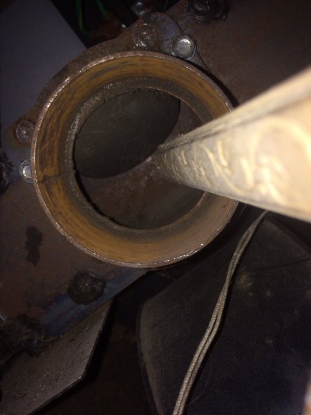

    Hello
    I just pushed the flapper in as far as it will go on my Harman Advance and it hits the back wall before it is fully open or fully vertical?
    See
  12. Lousyweather
    Lousyweather
    Dec 23, 2013
    2,798
    9,040
    It's fully open when it goes to the back wall....can't go any further
