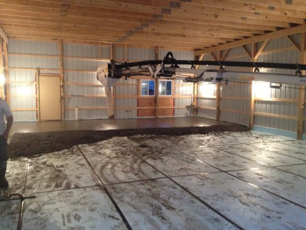

    I did mine as a pole barn so no foundation, except for the poles that are all set below the frost line. The 6" concrete floor sits on 2" of foam and has a 2" foam border.

    I built a 32x48 garage/barn a few years ago. It is not insulated or heated but it was built with the plan to someday insulate it to make a usable winter workshop.
    After much research, hemming, hawing, and considering, I decided on a metal pole barn with insulated slab. The pole building was much quicker and cheaper than a full below frost line foundation but is still anchored below the frost line unlike a floating slab.
    The 6" of concrete sits on and is surrounded by 2" of foam. It is fiber reinforced and only has rebar near the doorways. Not a single crack after several years. I put in several PVC conduits through and under the floor to bring in and out electrical, plumbing, gas, and who knows what else.
