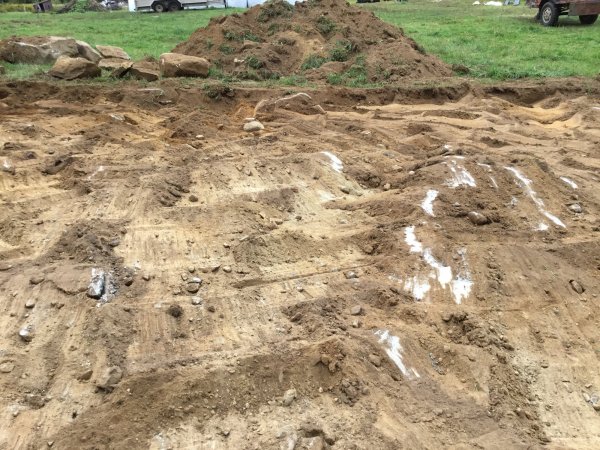

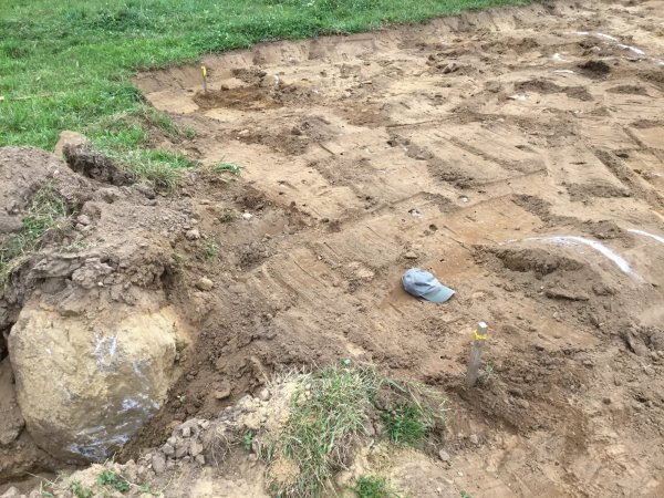

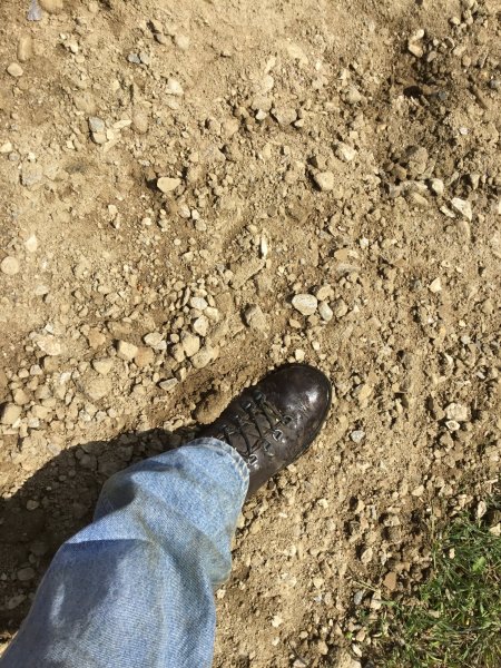

    2’ is the max depth, and I’ll be sure to add ample taper. In the pic below the pad runs up from the rock on the right (end of trench for electrical) to the short stake with yellow flag (20’), and then a woodshed continues on to the left, up to the hat on the ground (in line with the left side of the big rock). I can cut the slope above and have a reverse-tilt/swale to send water away, which would reduce the 2’ lift to something less. I told the local gravel pit operator what I was up to, and the second pic is what they sent.

    I call that bank run

    I didn’t go quite that far when I saw it, but it definitely has more fines than I was expecting. I have a few yards of crushed stone I can use, too.

    I would not bother compacting the basement if he uses #57 limestone.
    what the gravel guy sent does have more fines than I normally see but after you compact that it will be like concrete. Also next load might have more stone it does vary. A little hydration on that and it will get hard.

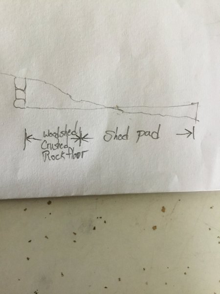

    I checked with my cheap laser level at dusk (so I can see the line), and I’ve got nearly 3’ of drop across the 32’ from the back of the woodshed to the front of the pad. Looks like a small rock retaining wall at the back of the woodshed might do the trick. I have no lack of rock, but wish I were more artistic with it. The pad area itself has 15” of drop.
    I’m hiring a neighbor who retired from his concrete business but can’t sit still in retirement. He currently has family visiting, so I’m not pestering him with these questions, but am trying to get as much done as I can ahead of him, plus I’m out on vacation.

    For your shed, it sounds like your small rock retaining wall is what I'd do with a fill of that depth, along with possibly allowing 4-5' of walkable space between the new shed wall and your retaining rock wall that even a 3', you don't want to fall off.

    I wasn’t clear on saying where the retaining wall was being proposed. I’m thinking of doing a deeper cut and have the wall on the uphill side. It will be damp at times in the woodshed floor, but I have some rubber roofing material I could put on the backside of the wall, and there isn’t much ground further upslope to send surface flow in that direction.
    This shed is actually a sugar house, but I’m building it with an eye toward being useful to the next owner. I’m thinking of putting 2” foam under the slab. Is this overkill for such a relatively small building, especially since it is a floating slab (so no perimeter insulation down to the frost line)?

    Drainage is the best goal. That is further out perimeter (up hill) surface water and close in (roof run off ) having a positive slope away from your slab. Proper grading is the best and cheapest way to NOT get into a fight with gravity, who's rules don't bend and are consistent. If you decide to foam under the slab, extend it out beyond the slab edge 2'. This will help in keeping the cold air from under the slab and possible heaving. You can cover the extended foam with gravel and a little slope in the foam away will be a big help. There's good info (that I learned from) on the Internet - try "frost protected shallow foundations" and "picture's".

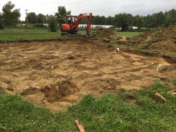

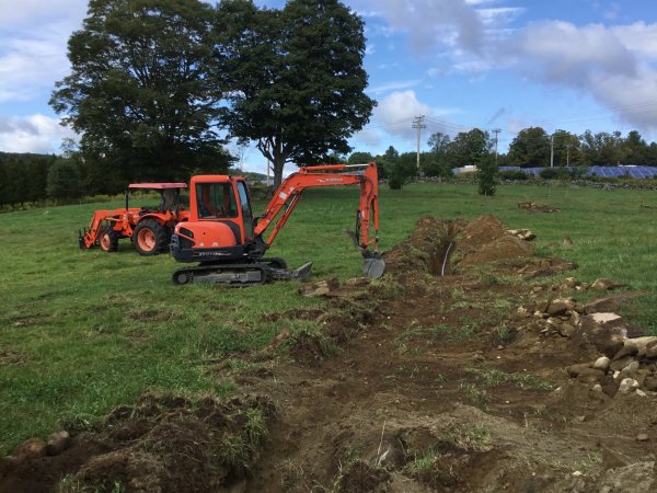

    This ledge (or Big Rock) might determine the grade. First day on the job running the cleanup bucket on the excavator? Yup!

    Run of the mill rock I found in the electrical trench, on the left. Rock of unknown size to the right of the hat. Streak of ledge in upper right corner of the pic.

    The ledge (bedrock outside of NE) will limit your elevation choices, but clean it up and gravel it flat. It's not going to heave! Gotta look on the bright side.
