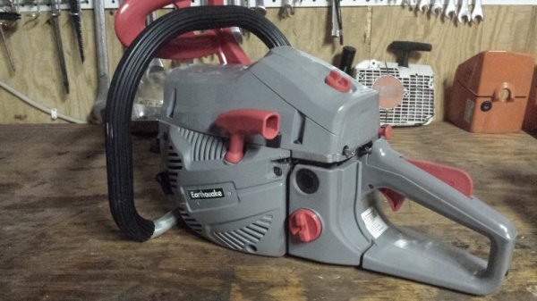

    I have a 52 cc that is destined to be my contest entry.

    Mine is a naked 45 cc machine :whistle:

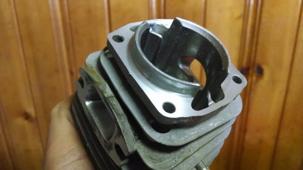

  5. Carbine
    Carbine
    Feb 2, 2014
    1,224
    3,864
  6. Carbine
    Carbine
    Feb 2, 2014
    1,224
    3,864
    Nothing crazy going on boys. I decided I would actually like to put this cheapie to work once on a while since I like it so much, I didn't take it far at all. I will have to bring a decent chain for sure.

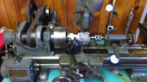

  7. Carbine
    Carbine
    Feb 2, 2014
    1,224
    3,864
  8. Carbine
    Carbine
    Feb 2, 2014
    1,224
    3,864
    I swear one of these days I will start doing this for money :D.

    I know a guy, who knows a guy, who needs a squish band cut? Think you could hook a brotha up? ;) It's for the same saw, but a 58 cc cylinder. :cool:

  10. mdavlee
    mdavlee
    Oct 21, 2013
    4,380
    10,479
    Looks like you've been busy:cool:

    We can get something squared away. I am out of round stock for mandrels, and I need to find a decent source. There is a machine shop down the road I am going to check into, hopefully I can snag some acrylic or something on the cheap.
    I do not have a 4 jaw on this lathe, and to cut your chamber that is what we really need. As it sits now, cutting bases and pop-ups are fine on a 3 jaw.. but the right way to cut a chamber is to set up a base plate like ecsaws and randy have shown on AS and use the 4 jaw to indicate it in. However you want to do it, we'll get you squared away. :cool:

    A popup would work on one of those. It will get the exhaust down some and give you more compression to play with.

    It doesn't need squish cut.. It does rum pretty good :)
