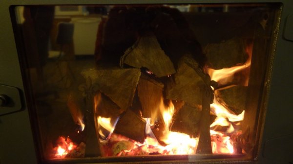

    That is a really nice pic. How long of those splits? Almost looks like the firebox is more usable than the 30 based on this load.
  10. papadave
    Flamestead, how many splits was that load in the pic?
    I think I'm counting 12 of various sizes, and there's room for a few more.

    I didn't really pay attention, so let's try again.
    After it is loaded...
    And before...
    (That's an 18" x 48" hearth extender, and the wider floor boards are 4.75" (splits are not huge))

    In under 4 hours we can be down to a big pile of coals that you can still see the grain of the wood in, but that have lost the shape/structure of being a log.
    I tend to do smaller, more frequent loads when I am home, rather than trying for as few as possible (I tend to not run very hot when filled, and normally would not have done a load as large as pictured above; aim to have a few inches between the load and the secondaries inlet).
    The load pictured above is now at 500 degree stovetop and two small areas of weak flame on top (largely black in the firebox).

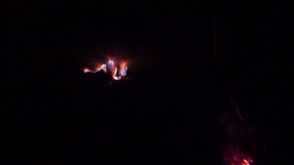

    Lower right corner shows where there is an air inlet (no flames, just glowing). I can comfortably hold my hand within half an inch of the glass. Hottest spot on top is at 500, flue probe is just below 400. It is 33 degrees outside, no wind, drizzle. Still have room to cut airflow. I can get my PH to do this for half an hour or so at the most, but then the secondaries kick up. Woodstock will be here in 12 hours to test a modified door latch, so at some point tonight I'll need to introduce some air.

    At that rate, it's gotta be making some serious BTU's. Not surprising after seeing the pic of your house, lot of footage. Where is the draft set burning at this rate, 1/4 -1/2? How do you think the Steel stacks up to the PH? Any preference?

    I am 100% with you on the need for wood to be consumed rapidly in order to generate high rates of heat output. I've had people question my PH burn rate, so I've done the math for a 75% of rated max output, and it comes out to relatively short burn times for my Red Maple loads.

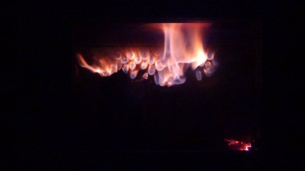

    Draft had 1.5" of travel remaining. I've since closed it to about 1" of travel because the stovetop inched up to 525 degrees and the secondaries were spreading across the whole top of the firebox. Flue probe stack at 400 degrees. Hottest spot on the box is on the front, just above the door (right in front of the cat).
    My message back to Woodstock will be to rebuild my PH to give me this degree of control - this stove (Ideal Steel) is in a completely different league than the PH on these low burns. I would seriously consider an expensive retrofit to my PH to get this flexibility. I would put up with an ugly kludge back at the PH draft inlet to get this control.
    As for the high burns, the PH cranks out a lot of heat and it gets rid of my coals more quickly, so small advantage to the PH.

    I think it has about 8" of arc.
    I've closed it down a little more because it was starting to heat up the firebox more. In addition to very slow secondaries, I am having the occasional ghost of flame along the front glass.
