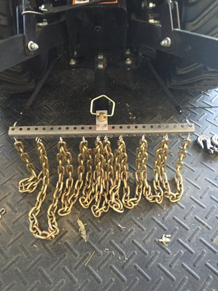

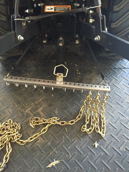

    I roll it in the spring. The stripes from the pic I posted are just from mowing. The pic of the chains on the back is my DIY striping kit. The chains lay the grass down in the middle between the tires giving a full striped pattern while I mow.

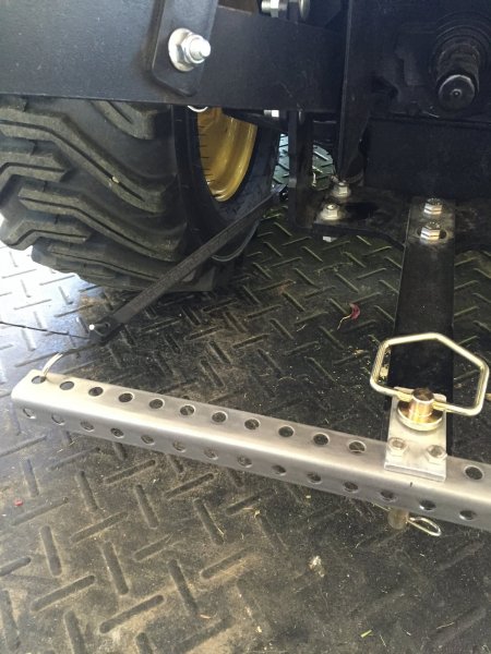

    Be very careful with your lawn striper. If you hang one of those chains up on something it will not be good. I have a BX and a lawn striper has been on my to do list for a long time. I just finished my OCDC in time to use it for the last mowing this year.

    That OCDC is pretty cool! I designed my striper kit to be forgiving and accident free. I have had a chain jump off the bar and drive over it with the back wheels several times. The bungees and hitch pin all make it very forgiving if snagged, ran over or bumped into.
