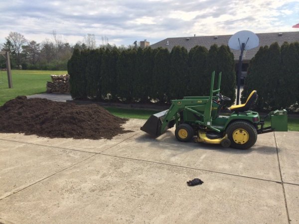

    Def a nice setup you have there Chvymn99!! The john deere GT series with attachments are hard to beat for home projects and mowing! I use mine for all kinds of stuff as well!
    4WD in the winter would def be nice though and I could really use something with a little more capability and a quick attach backhoe. I am going out to a dealer this week to test drive the 1025R and see how it compares to my 445.

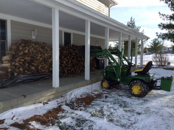

    Couple more I just found from this winter.
    It's def a nice piece of equipment, I'd just like something a little bigger

    You need more ballast on the 3 pt. Having a loaded loader to the point of losing rear traction is a very dangerous situation. Would not take very much at all to roll the machine at that point.
    Not just a safety issue either. 3 pt ballast actually relieves load on relatively delicate and expensive front end components ensuring they last much longer. Front tires fare much better as well. I would figure out what max lift is on your 3pt or look and see if the manufacturer has ballast recommendations for loaders. Most do. Deere gets a little crazy with recommending wheel weights and tire ballast, in addition to tons of weight on the 3pt. While I consider the tire ballast and WW optional on this size tractor, I would hang as much weight as is practical off the 3 pt.

    Nice set up you've got yourself. I've looked at the next step up, but really can justify it for the size of my lot (would love it, especially the extra hydraulic capacity). How much weight do you have on the back of that? I've got my tires loaded with about 130 lbs in each rear and 75 cast on each tire. Plus I throw on usually 6 of those suit case weights on the 3pt hitch.

    I bet that trailer hitch on the 3pt is handy.
