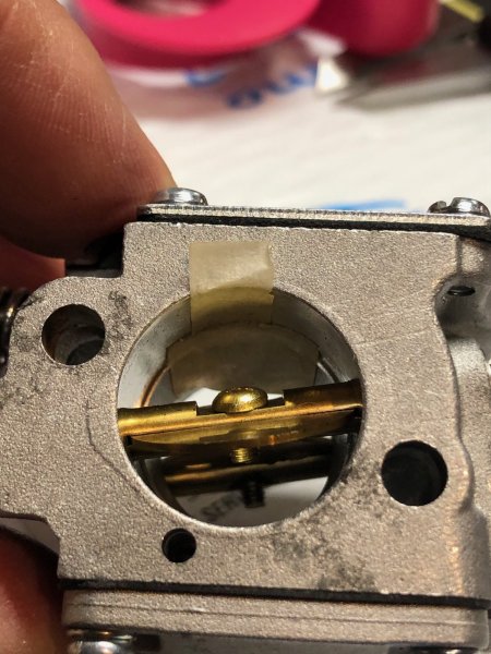

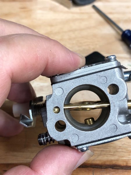

    Have you tried trimming the edges of the choke and throttle blades along with thinning the shafts / screw streamlining?
    I changed out the screws on my 288 clone carb to brass so I could peen them easier than steel screws (used loc-tite also). Then taped over the hi nozzle, low speed holes in the venturi, and any other open holes in the carb to keep shavings out. Then I went after it with the carbide burrs to get a smoother flow at WOT. I didn't do any b-4 / after timed cuts on just this mod, but I can't imagine it didn't help. There were LOTs of other mods to this saw. Flow, flow, and flow seem to be the major theme to performance.

    I know that's an upgrade some do. I haven't tried it yet myself.

    It wasn't hard to do, but it was time consuming. I used that saw as a learning experience, along with all the others I've worked on. I'm still a rookie at building saws but it's fun learning new stuff.

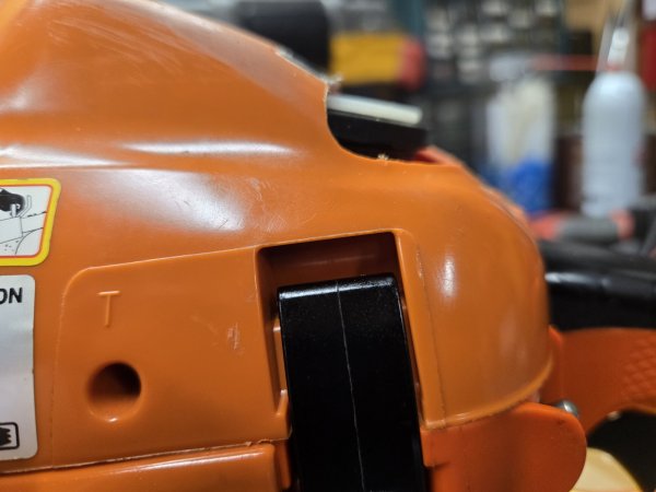

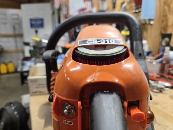

    CS310 is finished.
  8. eatonpcat
    10,393
    59,423
    Fits perfect now, nice job!
