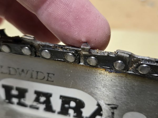

    I had to take it to the lines on the cutters to fix it. One cutter was broken off. The chain had, maybe, 25% cutter length left. It on its last sharpening now for sure. Below is when the damaged happened. I thought I had fixed the chain but either didn't, or didn't grind enough. The first go round. 20250819_130555.jpg

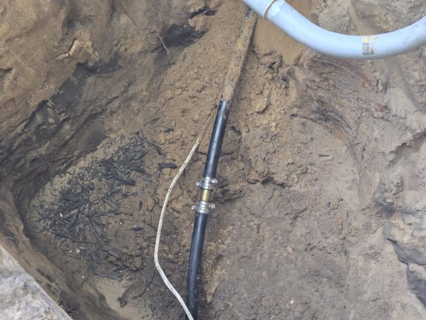

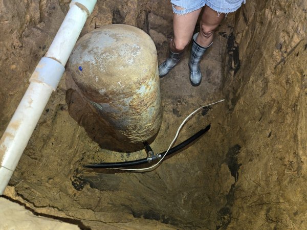

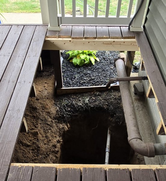

    In late October/ early November a new deck is being built. Our 28 year old 4x4 posts are starting to rot off at the ground. It will be built with proper 4x6 or 6x6 this time and composite decking, stainless screws and powder coated aluminum railing. There was no was we were leaving that metal well tank under there with a new deck covering it up. We have a new fiberglass tank buried by the 4in submersible well.

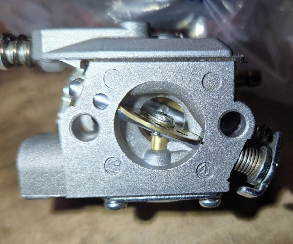

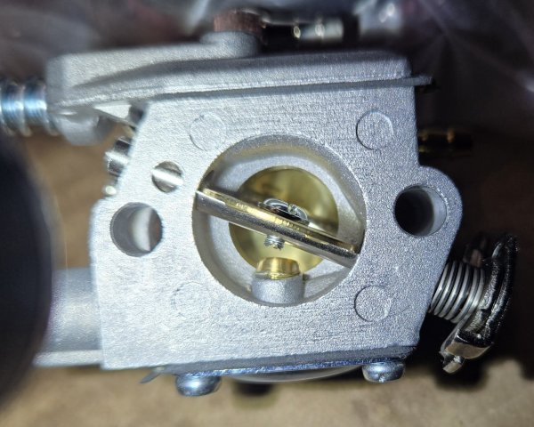

    CS-310 updates...
    The original carb.
    The new cs400 carb thats installed on it.
    T.Jeff Veal and ammoaddict like this.

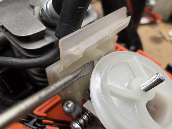

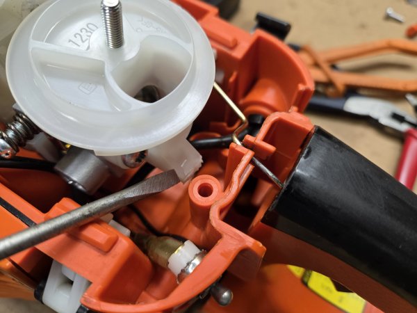

    The areas I'm pointing at with the screwdriver had to be trimmed so the cs400 air filter adapter would tighten up squarely to the carburetor.

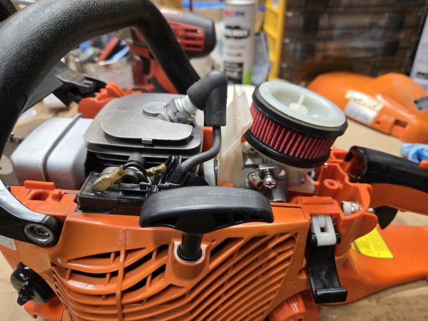

    I still need to trim a 1/2 moon slot in the lid so it closes.

    That metal tank didn't have many years left in it. Good call!

    No it did not. Lol
