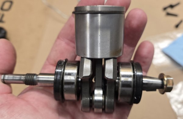

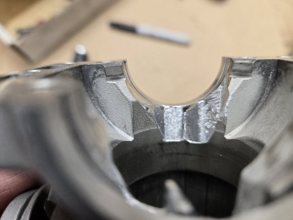

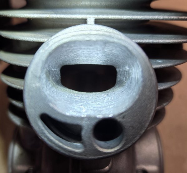

    And so it begins... 20250904_102412.jpg 20250904_102459.jpg 20250904_103105.jpg 20250904_103445.jpg 20250904_103452.jpg 20250904_103536.jpg 20250904_103544.jpg

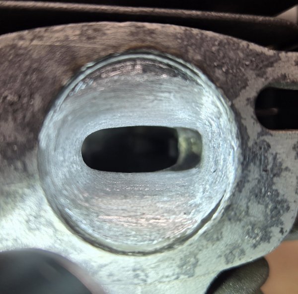

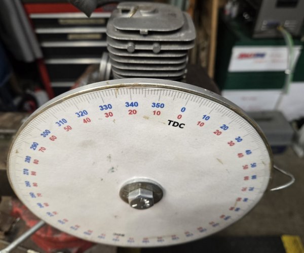

    Exhaust port is 17.5mm wide. The bore is 36mm. Target width is 23.4mm, which is 65% of bore. Im also aiming for 110° on Exhaust opening.

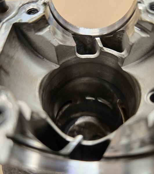

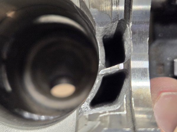

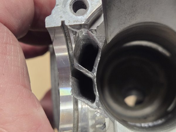

    Exhaust and intake roughed in.

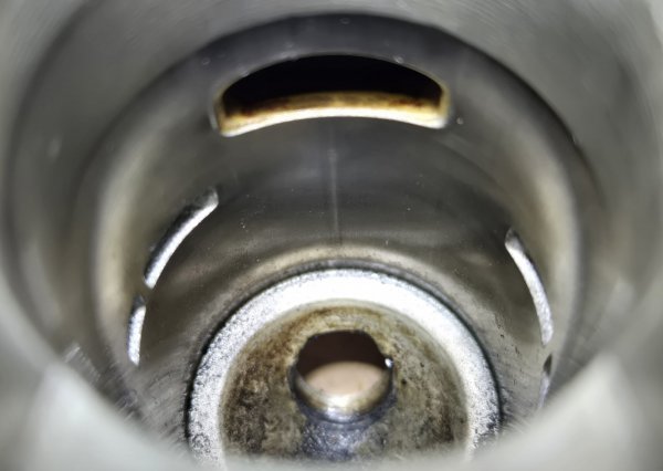

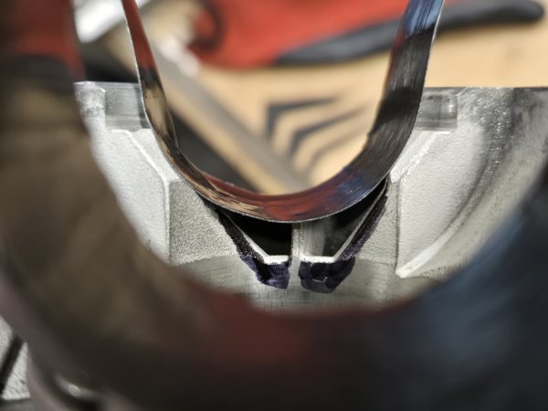

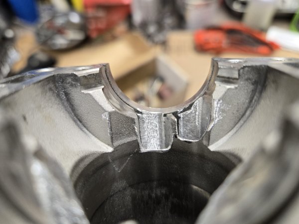

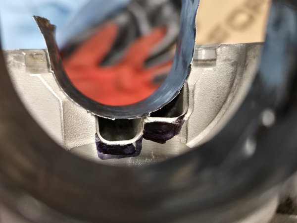

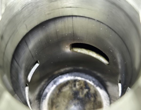

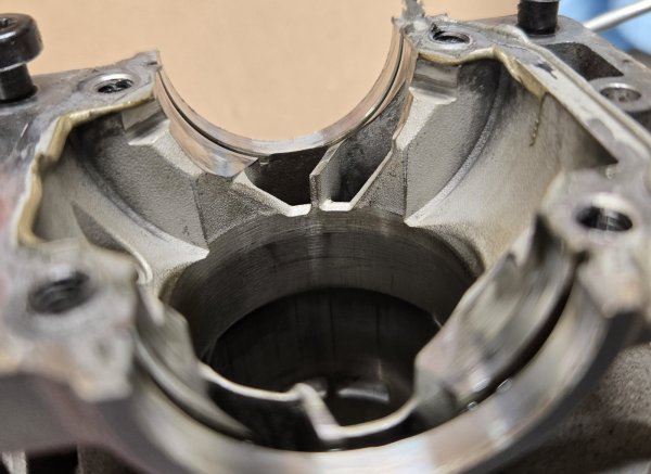

    All ports are at my desired size, shape and degrees. I still need to polish the exhaust port and hand sand the port chamfers. Phone cameras sure make things look like a 5 year old went after it with a rasp. Lol
    20250904_134840.jpg 20250904_134849.jpg 20250904_142118.jpg 20250904_142126.jpg 20250904_142139.jpg 20250904_142144.jpg

    Exhaust port on the cs310 is as polished as it's going to get. Reassembly is underway. 20250906_123357.jpg
