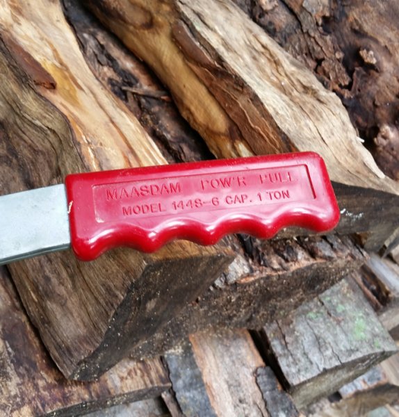

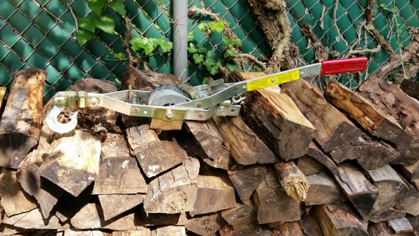

    Pics of the Maasdam puller being discussed, as it came up earlier in the thread.
    Pics include rain-drenched silver maple from the "next year" pile as an added bonus :D

    The cable style with a drum only allows like a 2 or 3 foot pull before having to reset. A 60 foot "rope" easily stretches that far with moderate weight on it.
    The rope style, you dont have to be reset, can be set inline and are not limited to pulling a few feet. Or resetting.
    Just clearing up the differences as I think there was some confusion on the idea that if it comes with a rope you must be able to use a rope.
    I would hate to see somone hurt or worse.

    I learned something today from this site. Maasdam makes more than rope pullers. That clears up some of the confusion earlier in the thread.:BrianK::salute:
