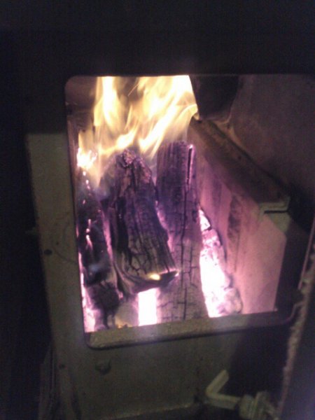

    Got any other pictures of your stove? Tried googling it (not sure which would be yours) as I've never heard/seen one before. Looks like it can hold a good bit of wood as the firebox looks nice and deep.

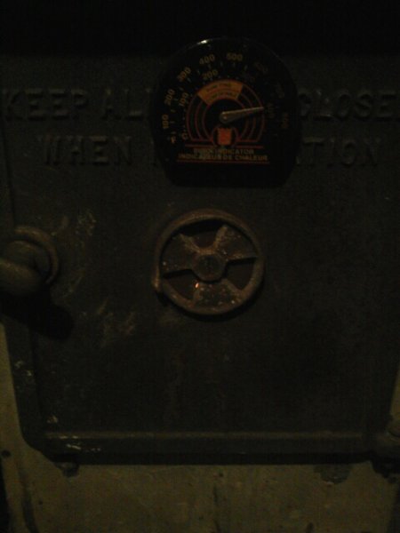

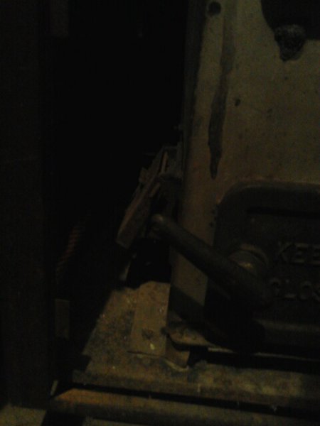

    Biggest limiting factor is the burn box is made with 16 ga aluminized steel- very quick to get the top glowing if not careful....
    These are the main air adjustments:
    Bi-metallic thermostatically operated bottom air, which you can set, but if the stove gets too hot, it will close itself,
    Cools down, it opens back up-
    Regular 3 hole air on the door, above the fire-
    And in the upper right, the flue exit with built in adjustable damper-
    Decent wood MC wise, smoke outa the chimley :mad:
    Guess it's to be expected from an old stove tho...
    Now, most everyone here hasn't had an older stove for a WHILE, but try to remember back when....
    Any advice on keeping the top from glowing, but cutting down on smoke?
    Thanks for looking/advising:yes:

    I'd try smaller loads of bigger splits for the glowing ... which might cause more smoke ... hmmm. Maybe some of the older gentlemen on the site can chime in :).

    Eric VW Is your primary air turned down? You can try turning down the air much sooner. You may have an airleak too. Test a cold stove door and ashpan door (if you have an ashpan door) using a dollar bill. Insert dollar bill bis cold.tween stove and door, close door and latch, if easily pulled through, definitely replace the gasket. Test doors completely. Good luck, you dont want a glowing orange stove. Check for any warping or cracks when stove is cold.
