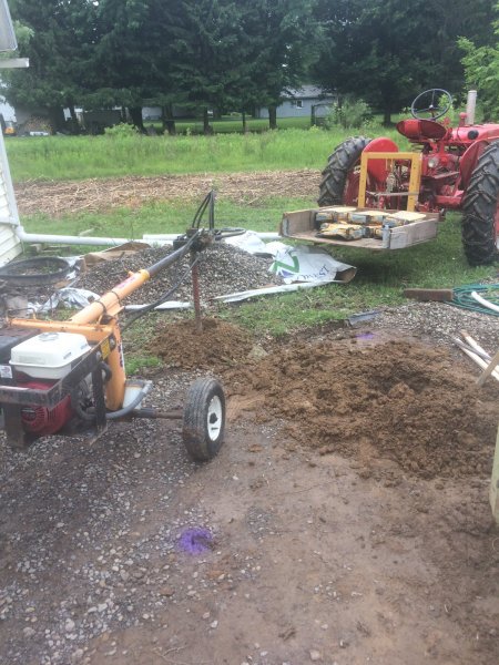

    Make one you won't regret it even if you have a loader! The angle iron Tsc 3pt. "Forks" are fairly cheap and a bit of scrap lumber, or better stuff if you've got it I use mine all the time even for odd length rounds and splits I made short sides and a removable tailgate that can slide in against some stop blocks at the desired firewood length. Mine is a half sheet of 3/4 plywood, some carriage bolts to put it down to the frame and some 2x8 sides. I've had some boulders in it that had my front wheels in the air and havent busted it yet. Helping with the pool deck last summer here IMG_0833.JPG

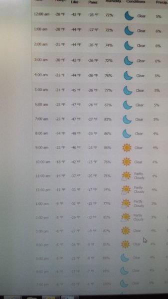

    Feel free to bounce over and hit my place on the next snow. Better plug in its gonna be cold this weekend! 20161215_120031.jpg
