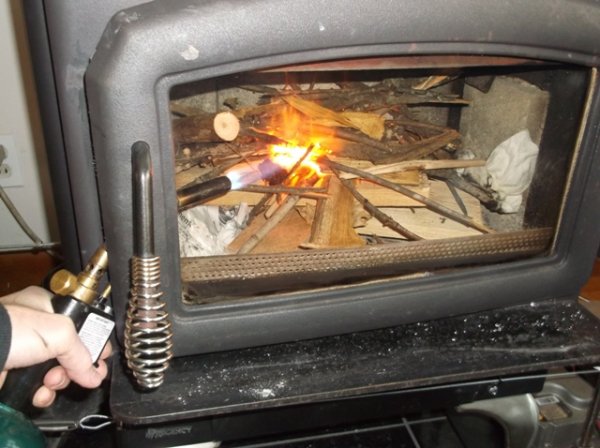

    Get this one, TS-8000 heavy duty one, no better way to light a fire IMO, you can warm the flue if needed,
    use a fire starter or just kindling, open the door just enough to fit the torch in, and fire will be blazing in no time.
  3. bobdog2o02
    bobdog2o02
    Nov 19, 2015
    3,010
    10,445
    Drury Lane, PA
    Is that a gas valve on the side? That would be nice.

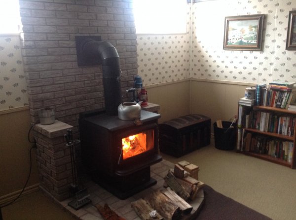

  7. Smoketr1973
    Smoketr1973
    Jul 19, 2015
    82
    586
    Vinemount, Ontario, Canada
    I have the same problem on occasion. Basement stove with the chimney in an ouside wall. I know it seems crazy, but what works for me is to open a window in the basement closest to the stove and let the cold air poor in for a couple of minutes before I even try to light the stove. I think the house goes into a negative airflow due to exhaust fans, clothes dryer etc. After a few minutes the basement equalizes with the rest of the house and the cold air stops flowing out of the stove. Get a quick hot fire going with lots of paper and small splits, 1/2 later and everything is warm plus the house got a bit of fresh air. Never had any smoke outs after discovering this from an old timer that heats with wood and has a similar set up to mine. Good luck.
  8. Smoketr1973
    Smoketr1973
    Jul 19, 2015
    82
    586
    Not a great picture but I crack open the window on either side about 2" and it works pretty fast.
  9. B_Williams
    B_Williams
    Jan 13, 2014
    226
    594
    Maryland
    I cracked the window but it was after I'd started the whole ordeal. Tried to do a quick, hot fire with kindling. REALLY REALLY filled the basement with smoke now. It burned but the smoke just pumped into the room. I may try again later today. Everything's airing out now. There's even a little smile on the main level now. Not a good start to the day...
