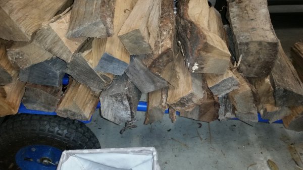

    Need your definition of a "log".
    Pics might help.

    you guys had me rolling on the log pic, was debating putting up a pic of a turd, yea I may be middle aged but I'm still in eight grade. lol flat earth.
    I'm burning oak now, that's all that's sort of ready besides the poplar but I typically burn that outside, about 4 splits fills my box. keep in mind it's for coal, it holds about 70#of nut.

    I'd like to do the criss cross thing but I'd need 2 different length of logs, 20" and 12", is it worth the effort? you think the size of the splits I have in the pic are too big?
    none of the wood I'm burning sizzles, it lights up pretty much instantly. I love burning poplar, great visual flames, the stuff I have is super light.
