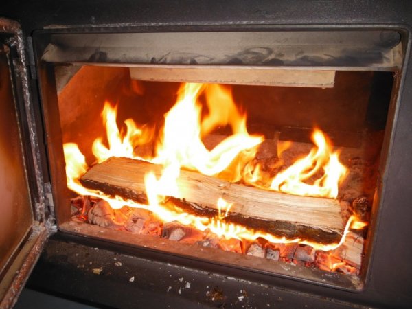

  4. bogydave
    Need heat when doing your coal burn down;
    Rake forward
    place a split on top, set on high ;;; if you have lots of coals, may take 2 or 3 times.

    Backwoods and Bogy, I'll take your advice and see what happens, guess I have been waiting a bit long on that. Could be the result of my shoulder season habits. damm, it gets warm in here when this thing is running anyplace past 450'. So, in shoulder season that a lot of times has been coinciding with a warmer part of the day as well. Like early mid afternoon.. so I prolly get in this habit of just letting the stove get too cool before I start paying attention to the coaling.
    I'll let you know how I make out. Bogy I just threw a real dry split into the top of the coals to heat her up.

    For sure no coaling problems in shoulder season. It is when it is cold outdoors where people run into problems. Today I had an appointment in town and we needed to empty ashes and also burn down some coals. So, we did put one split on the coals and got that going nicely. Went to town. When we came back the coals were far enough down to remove some ash. Then we put in 4 good splits and it is still going well.
