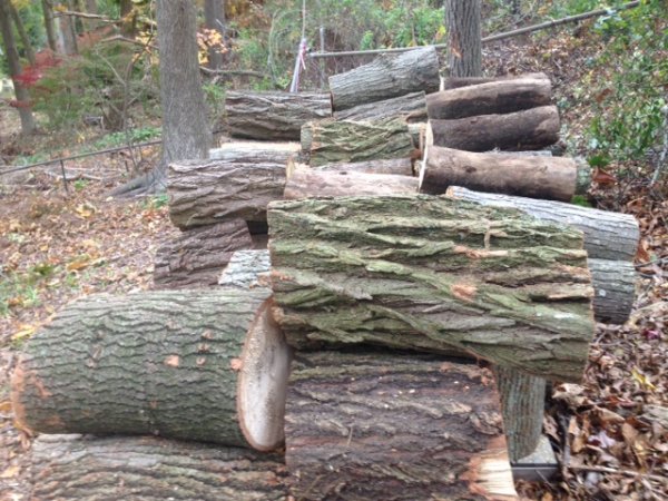

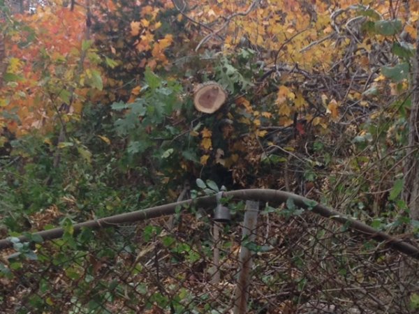

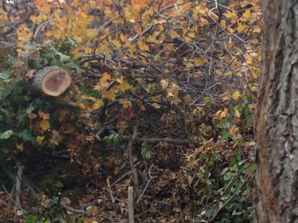

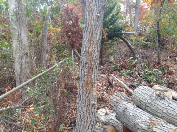

    Actually posted this elsewhere but kind of a safety thing so figured it maybe serves as a reminder. Back in August we had a major that left an oak leaner hung up about 20' up on a sassafras. Couple days ago the remains of Patricia knocked it down, still on the sass but at a height that I could cut it.
    Now I've always freely admitted I'm no chainsaw expert but I've read and learned from the more experienced folks here and there and watched the BC feller series. This has given me a healthy respect (fear :)) of what can happen.
    After cutting everything hanging freely, I started cutting the section against the standing sass. My first cut was a top cut made from the uphill side with the sass between me and the leaner. I cut about 1/4 way through watching carefully for any binding. Satisfied with the top cut I started in from the bottom.
    As my bottom cut approached the top cut, it started to close as the tree settled which I expected so I went after it. All of a sudden there was movement and being a novice it didn't register fast enough and next thing I know the bar is stuck. Now I couldn't figure out how it could be binding both top and bottom but stuck it was.
    There was just a little holding wood so I grabbed a bow saw and started to cut with my right hand and holding the saw (off with brake on) in my left. Still with the sass between me and the leaner. Suddenly and without warning the tree broke free and shot uphill (towards me) about 4'. It was like I released a trebuchet, if I was not protected by the sass it would have thrown me 20'.
    Turns out the binding was coming from the backside of the cut and looking back if the saw had not bound the tree would have caught the handle of the running saw as it went by and who knows what could've happened. In any case it nipped my knuckles but no damage.
    To guys that do this all the time this is probably a mundane story but for the rest of us be careful. In addition with the benefit of hindsight I should have seen this coming as it was "readable" although at this moment I don't know how it could be safely cut. That tension would have to be relieved maybe with a series of cuts. Wood cutting can be exciting.

    Not too fond of that sassafras. You may be onto something.

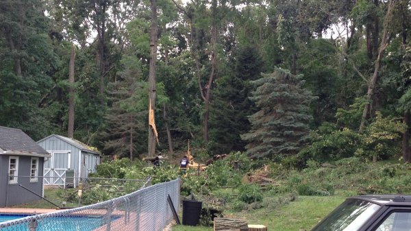

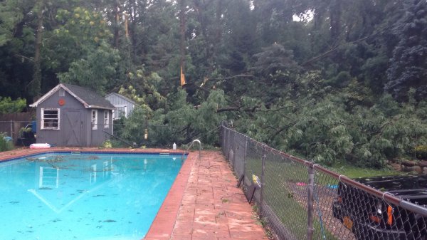

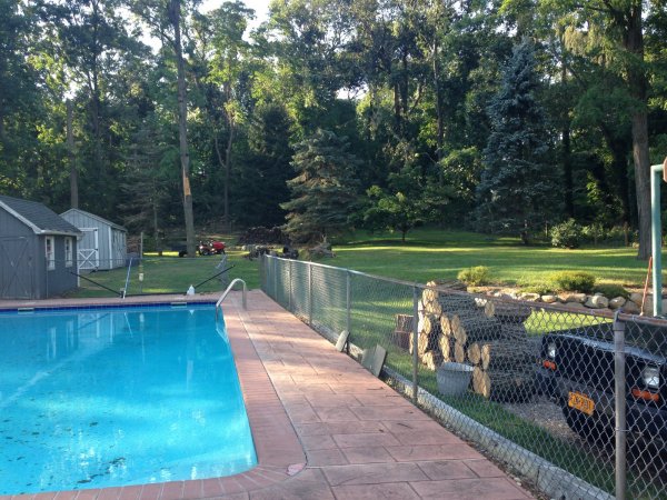

    Couple pics of my back yard in August. Leaner festival. Let the pros handle most of it. 18 trees down total. To give you idea of size, the tops in the right foreground are from trees that fell between my two sheds from my neighbors yard. Guess they were about 65-70'. Back where I was cutting today is from my back neighbor. Very dangerous back there from last 3 major storms.
