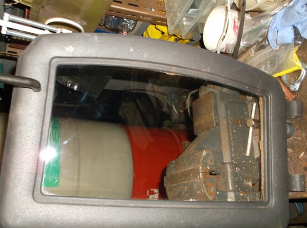

    I use the Rutland cleaner when the glass gets dirty, usually clean it before I start up from cold.
    The Cerium oxide works well if your glass has a permanent haze, I used an angle grinder with a buffing pad.
    It is a bit messy and does take a long time to polish out all of the haze but you can see the results.
    HDRock likes this.

    This is the sort of haze I'm looking at. Polishing is the next step. Thanks!
    HDRock likes this.
