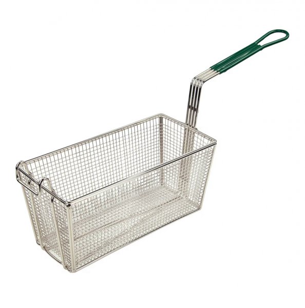

    I have when they get excessive. I use a fryolater basket. It does let soot into the room so
    I need to be careful.

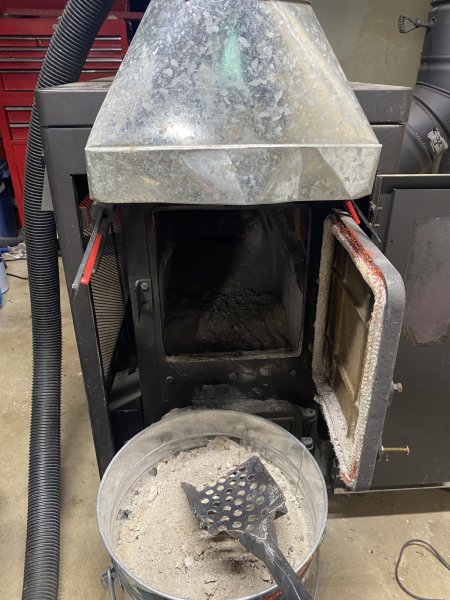

    Years ago, I devised this hood to clamp on to the stove, and the setup has a hole on the other side to allow the 2” shop vac hose to plug into the back… works pretty gooder at managing fines that want to take flight when depositing ashes into the steel bucket (tight fitting lid just out of frame). I use a “fine dust” yellow bag in the shop vac, but I really only use this setup when the stove is dead cold.
    I’ve had that shovel since the start (circa 2012) but just recently took it to the drill press for a little Swiss cheese treatment, and it works just as good for scooping ash as it does sifting with a couple of jolts to separate ash from larger coals.

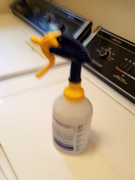

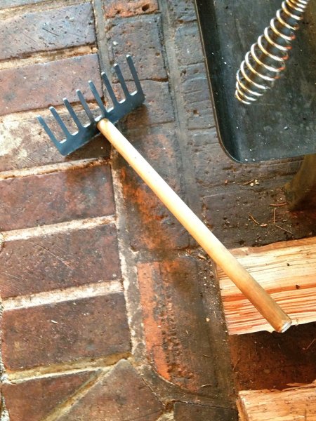

    I made a rake. I rake the coals forward and push the ashes back like many others. Usually at morning restart. When I am cleaning the ashes from the stove when they build up, I push them to the back of the cold stove and give them a good spray with the Wif's ironing mister. A couple of spritzes during the process kills the fly ash! I spray the top of the ash in the bucket also before whisking it to the garage. bats3enter.jpg bats4.jpg

    Hey nice rake
