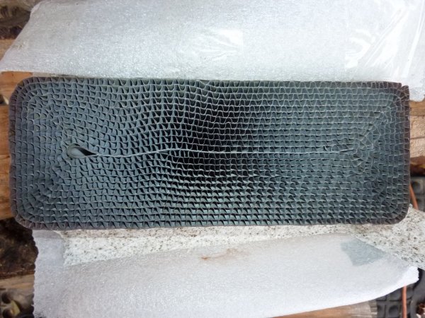

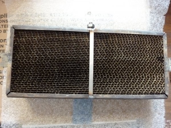

    The first steel cats were "diesel-foil." The newer ones are DuraFoil, which (I think, not clear on details) is a different construction and supposed to remain stable. Maybe thicker foil as well? I've seen the diesels shrivel, to the point I had to put extra layers of interam gasket around them to seal them into the cast iron frame. This one is from my Ks. It's in good shape and hasn't shriveled much at all, since I was careful to run it relatively cool...not bright orange. You can kind of see the mounting ears on this Dura. No cast iron frame or interam gasket needed; You lightly bolt them snug to the rope gasket around the opening with the shipping bolts. Dennis, you need to get the low-down on all the differences from your people at the plant. ;)
    Note the rows going straight, all the way across on the Dura:
