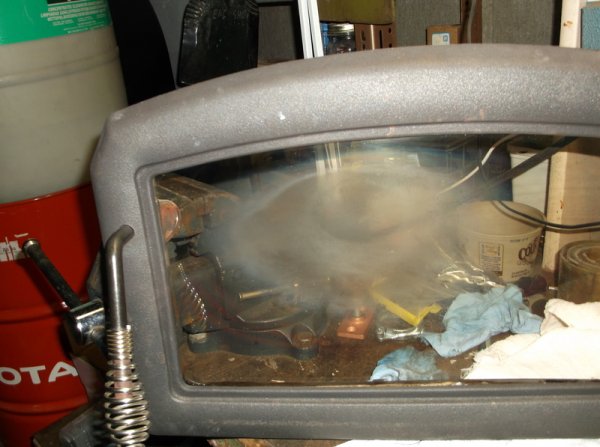

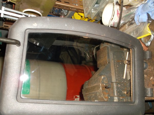

    If your glass is hazy and you can't clean it with ashes or stove glass cleaner, try this it works very well.
    My glass has a big hazy spot that I could not remove, tried ashes, Rutland cleaner, plastic polish, nothing worked.
    I ordered a 3" backing plate, polishing discs for a right angle grinder, and some cerium oxide glass polish and went to work.
    As you can see from the before and after pics the glass now looks like new.:)
    The polishing does take some time so you must be patient. I found it best to polish for 5 or 10 min
    take a break and let the glass cool down (it gets hot form the friction) and then polish some more.
    It is not necessary to remove glass from the door, some masking tape will make clean up easier.

    Thanks Wes. I've already started with the abrasion process, I guess at this point I have nothing to lose. One of the nice things about this Jotul (602) is that the glass comes out easy; just a couple of screws to loosen.
    How long in total did it take you?
    *edit* I remember that some toothpastes contain cerium oxide. I might give this a try.

    Probably took about an hour or so, do it a little at a time.
    Picked up the supplies from Ebay I think it was.
