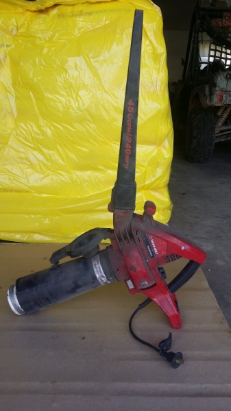

  14. DexterDay
    DexterDay Administrator
    12,411
    31,637
    Northeast Oh
    Great point for newbs who are looking for one.

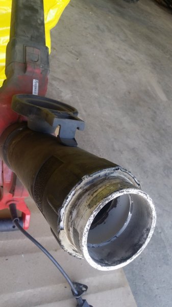

    This is a must. It can't just be a leaf blower. Remember, you are "sucking" the ash out of the vent/stove. .
    So it HAS to have the vacuum option. Plus, that long neck helps with making an adapter to fit your stove vent.
    I have a Troy-Bilt unit that is rated for 450 CFM and 240 MPH. Works great.
    I cut the vacuum suction tube down until I could fit a 4"-3" PVC reducer in it, then used liquid nails to make it permanent also seal it all up. .
    The 3" end fits on a 3" pellet vent (add some tape to seal) and it slips inside a 4" (also add tape to seal).
    ttdberg, imacman, slvrblkk and 2 others like this.

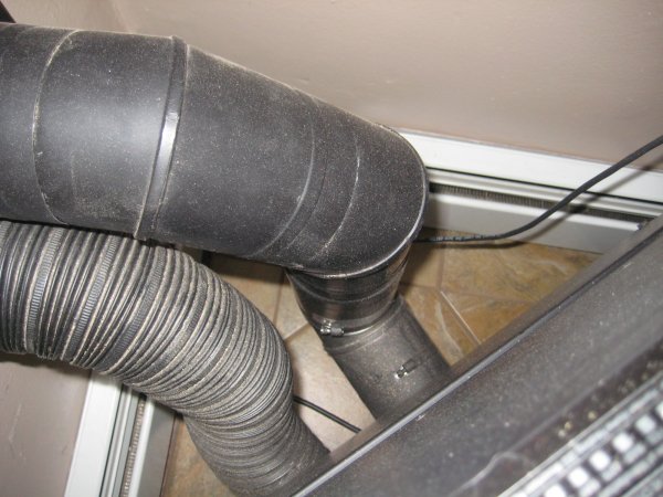

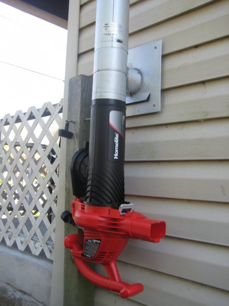

  18. Tullytown
    Tullytown
    Feb 15, 2015
    1,167
    3,509
    North of Phila Eagles.
    From Inside the stove behind the removed exhaust blower I push the ash from The exhaust tunnel Towards the Outside with a stiff bristle brush..
    It drops down to the bottom of a 90[still inside as shown]... then I connect the leaf blower while plugging up the vertical outside exhaust with a rag so as to get best suction.
    Remove the same rag then stuff it in the horizonal pipe so as to get the vertical pipe cleaned with again, best suction.
    Oh, and I also leave the door open a bit to save possible? damage to vacuum switch..
