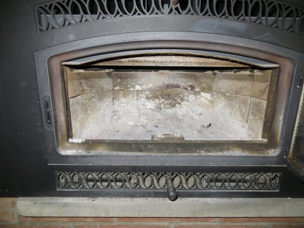

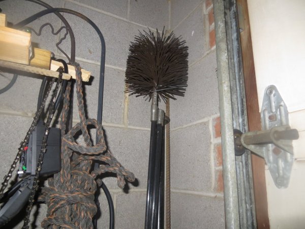

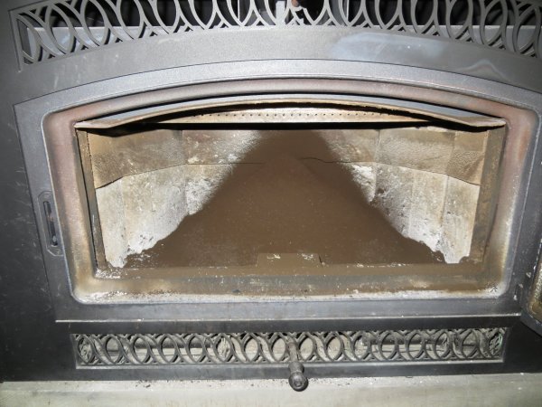

    I bought rods and a brush for my insert liner from a fireplace shop and probably over payed. I spray with this Rutland following their instructions.
    Just got up on roof a week ago. The first time I did it I couldn't turn the brush to be able to pull it back up. Realized the damper must be open.
    Took these before and after pictures.
    brenndatomu, Thor, jrider and 3 others like this.

    I use the rods and brush JoeinO posted pics of and they work great on my double wall ss. No way you’re going through a 90 degree. And it’s very difficult to switch directions while in the pipe. I have to go through one way, usually down from the top, then pull back out the top. I’m sure there’s better options for square/rectangle, that spinner looks good.
