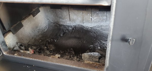

    12k hours for me is likely 2.75 to 3 years (I am almost through my second winter, 3 months to go). My stove provides 100% of my heating with seasons averaging about 8 months start to finish.
    I cleaned my chimney two days ago, and was shocked with the small amount of soot that came down. Easily less than a cup of fine powder after a full 6 months of heating. Very impressed.

    Note that most of the debris will be stuck up above the bypass and not fall to the firebox floor. You have to get up there behind the cat to clean it out.

    After brushing the pipe, I disconnect the pipe from the stove and brush the debris into the fire box. Seems to work pretty good that way. While I'm at it, I grease up the moving parts with some graphite grease. I'm sure it burns off, but it makes me feel better.

    With that big ol' 8" flue collar you could probably suck it all out with a shopvac from above. That's what I do with my princess. Just be sure that the bypass gasket is clear and the back of cat area doesn't have a pile.
