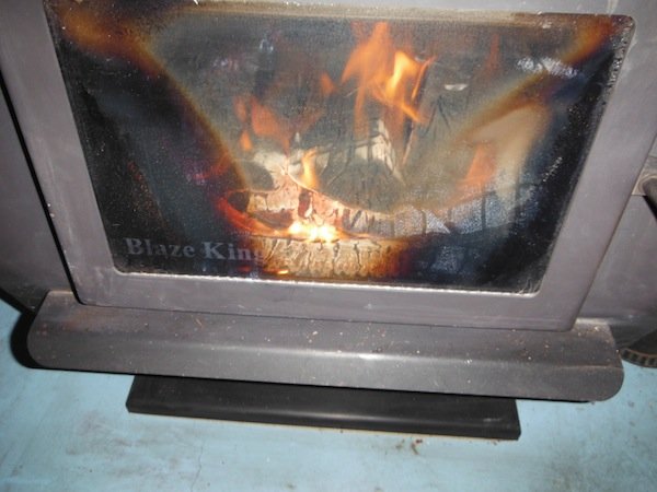

Cleaned the King today
Discussion in 'Modern EPA Stoves and Fireplaces' started by bogydave, Nov 5, 2014.
  1. Highbeam
    Highbeam
    Jun 25, 2014
    1,887
    6,030
    My princess looks exactly the same inside.
    Beetle-Kill and wildwest like this.
  2. bogydave
    I noticed more heat off the sides tonight.
    Makes sense, I guess . The creo was an insulator
    keeping heat in.

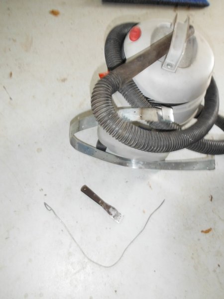

  8. bogydave
    I used Beetle-kills method on the sides.
    A 1" wide simpson tie strap is flexible enough to push/pull back & forth &push it to the back corner,
    and stiff enough to scrap the creo off the stove wall. It came off
    pretty easy, in small sheets & the strap broke it loose & pushed it to where i could get to it.
    End of the strap straight to break it loos, bent it to different angles then bent
    it over 180° to push the chunks to the back corner
    On the back one I use a stiff piece of wire. Bent 90° , long enough to reach from the
    top to the bottom & worked it back & forth.
    Stuck my hand up around the air pipe,
    wear gloves, I got bandaids to show why, stuff is hard & sharp as glass but very brittle.
    Breaks up & off pretty good, small putty knife helps too
    Shop vac .
    tools I used:
