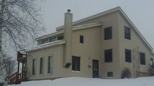

  6. Canadian border VT
    19,790
    131,935
    Sconnie Burner our chases are similar( although yours is prettier) mines got r 2 fiberboard. .. stoves are very similar, I got IS I think ash grate slots on your a little wider, my chase is 24 feet IIRC, my top cap has a screen which invariably gets a little bit in it creosote loozing stuff in screen... raising my chimney may get better draft but my draft is already around 60 pascals.. read high.. so I doubt more draft will help your problem.. Tom (owner of Woodstock) said my draft was high and suggested a key damper to lower draft. nonetheless I think what's happening is steam is mixing with a little ash and condensating like brenndatomu mentioned! 20150220_074053.jpg
