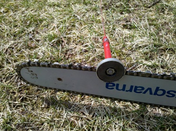

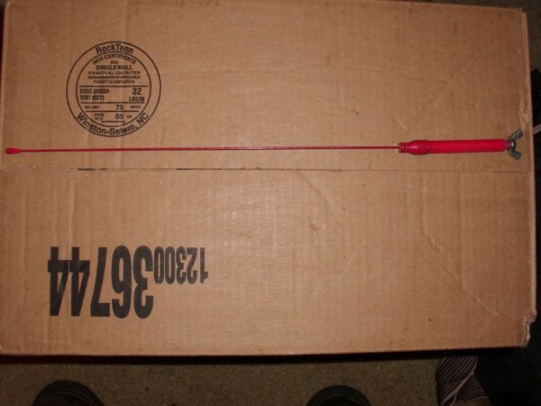

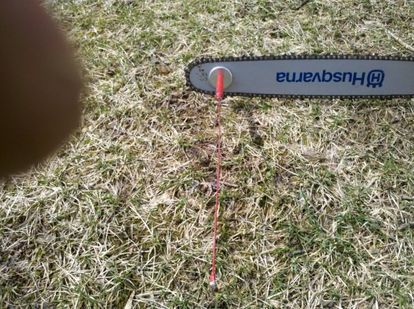

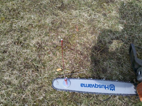

    Some other ways to measure rounds to length
    How I measure rounds to length
    Here is my whip antenna , it has a set screw for adjustable length , I cut to17"
    Started out with a wing nut ,then changed it to a magnet

    Is that a 2.5 inch magnet you are using?

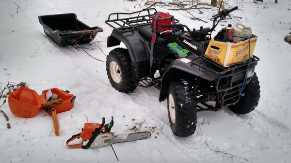

    I use this handy measuring whip that Bret Hart gave me. You can see it if you zoom in. IMG_20160123_132618013_HDR.jpg
    It's an air tool fitting male end welded to a bar nut. It works pretty darn well.

    1 1/2" di, got the magnet at HF
