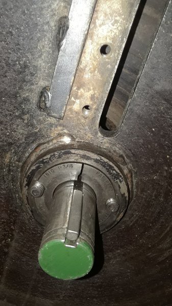

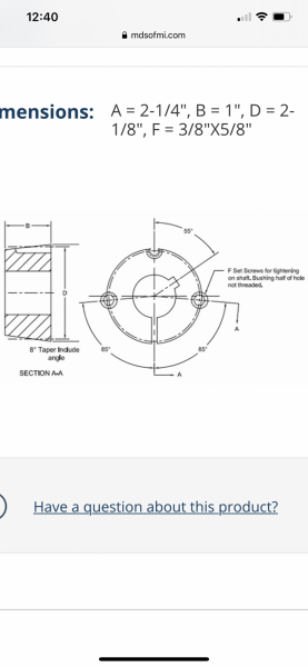

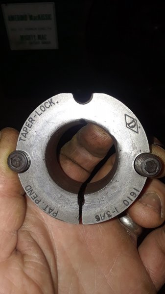

    Ok, I think I understand all this, not sure about the using a different set screw hole as the bushing doesn't seen to have a place for both to get rotated 180.
    I found some 1/4 key stock and am dry fitting. Forgive my ignorance here but I dont see how this key can engage the bushing. Maybe the key I need is not a standard square key? The groove in the bushing that the key engages is not square shaped, it appears to be like a pyramid.

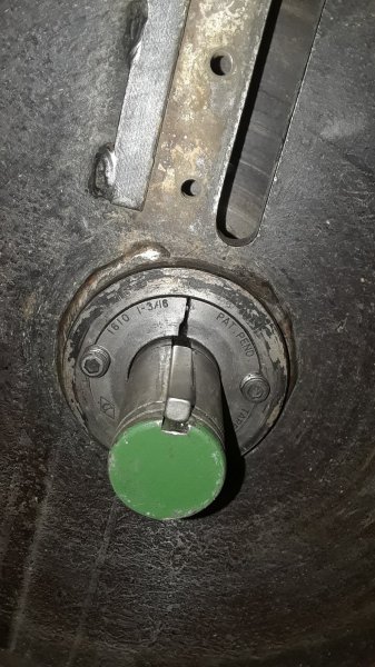

    I’m thinking that I’d personally replace it. It looks like your worn on that one edge pretty bad. Should be uniform eccentric. the last picture looks to be off...

    I'm thinking in the last picture you are seeing a shadow. The groove in the bushing for the key is/was never square IMO.
    I'll call the manufacturer tomorrow. Problem is last time I talked to them they did not recognize the serial number of the machine. Probably just buy a new bushing and key from them and get a couple of chipper knives while I'm at it.
    I'm assuming that the groove for the key is at the 6 o'clock position in the photo below, unlike the diagram above. Will that groove open up to 1/4 inch when I torque the set screws?

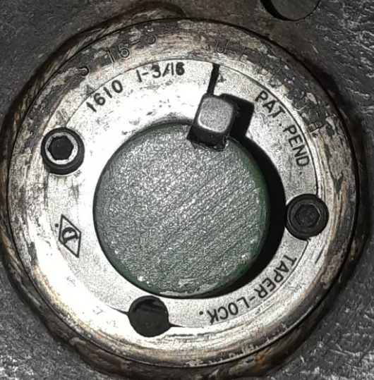

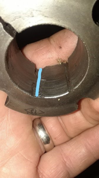

    This is what I was thinking was your keyway (blue line) honestly, probably gonna be easier to replace the whole thing rather than clean up this keyway proper like...not quite sure why the keyway is not obvious when looking at the end of the coupler...weird.
    taperlock_LI.jpg [​IMG] It should look exactly like this one. ^ ^ ^ NEW OLD STOCK! DODGE 1-3/16" TAPER LOCK BUSHING 1610-1-3/16 117160 | eBay
    The empty hole directly opposite your key in the below pic is your jack hole...you remove both screws, then thread one into the empty hole to jack the coupler free of the cutter wheel...they should have been locked tightly together. I bet things were not properly tight to begin with...otherwise you would have not gotten it apart without using the jack hole, or totally destroying things...explains why the key sheared off too.
    The NOS taperlocks I saw on ebay looked to be fairly inexpensive (in case one from the OEM one is too spendy)

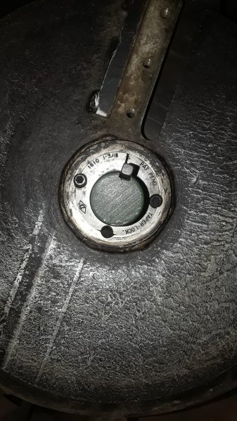

    No, it will close.
    The inside of the cutter wheel is tapered to match the outside of the taperlock coupler...when you thread the jack screws in the two opposing holes, the coupler gets drawn into the cutter wheel as you tighten the screws, and since you are pulling into that tapered hole, the gap will close up as the TL clamps tightly onto the shaft and key.
    Now if you look at that empty hole 90* away from the two we just discussed, (here, in about the 6:30-7:00 position)
    you will notice the coupler side has threads, but the cutter wheel side of the hole doesn't. Also, the half of the hole on the cutter wheel side is not drilled through...so basically a blind hole. So what happens when you thread a screw into that empty 3rd hole, the screw bottoms out on the blind bottom of the cutter wheel side of the hole, but that half is not threaded, so the screw can continue to be turned against the bottom...but, since the coupler half of that hole is threaded, the coupler gets pushed out as you turn the screw...as the coupler comes out of the tapered hole in the cutter, that gaps opens back up and everything should be loose and easily removed from the shaft...its a simple but genius design...I really like using taperlock couplers whenever I can...they are pretty common way to attach pulleys and sprockets to a shaft on industrial equipment...the pulley or sprocket is made special to accept the taperlock coupler just as your cutter wheel is.
    Here is a good pic of the inside of a taperlock pulley...it shows the threaded and unthreaded/blind holes really well.
    When assembling things, the smooth bore (and blind) holes in the taperlock coupler mate with the threaded holes in the pulley...and vise versa, the threaded hole in the coupler mates up with the smooth bore (blind) of the pulley, which remains unused until you need to force things back apart.

    Per the tech at Mackissic, the original bushing had an integral key, so it appears that gouge that you marked with blue is what's left of the key after it sheared off. Makes sense now.
    Parts are ordered.

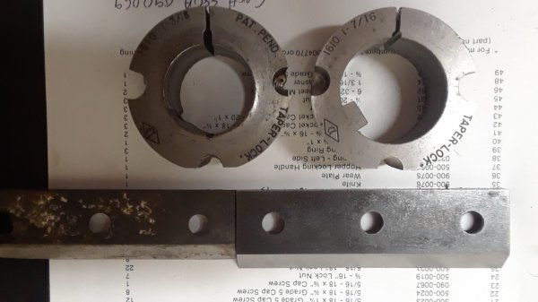

    Parts came Friday.
    Notice anything about the new bushing?
    Wrong size. Someone wrote the right part number on the wrong box.:headbang: They are sending the correct one post haste.
    It looks like that old knife has been sharpened quite a few times too.

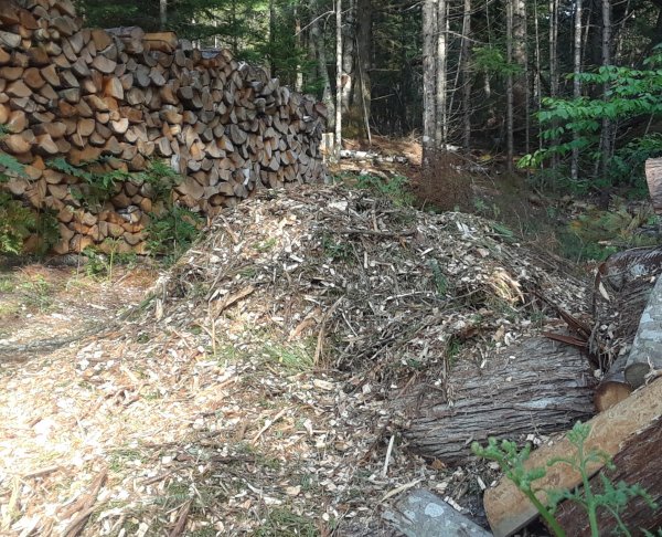

    The correct bushing finally arrived. The chipper is all back together and working well got prolly a couple yards worth of chips in an hour or so.
