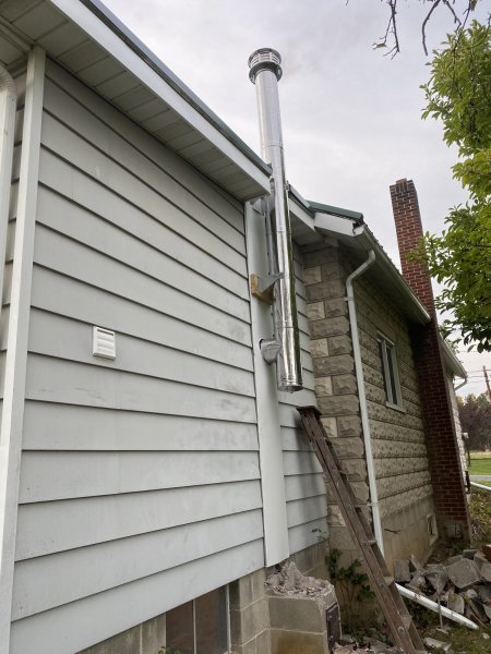

    Well it’s done only took 20 Miller lites and a sixer of Sammy Adams Oktoberfest 1C0B777A-B012-493A-82FB-950A10E79548.jpeg

    We had a similar incident. 15-20 years ago, I cleaned our exterior masonry chimney with an extension ladder in September. While carrying the ladder away, "oh darn", I forgot to inspect the chimney. Back went the ladder, up went the flash light, and "oh d***". The liner was severely cracked from top to bottom. After researching my choices, I settled on triple wall stainless which had the highest chimney fire rating at that time. Rented scaffolding for a week and the sledge hammer converted the chimney to rubble in half a day (excluding the footing). One more day had the new chimney up and another day to trim the roof.
    The biggest difference between the masonry and insulated stainless steel: a LOT less creosote, one cleaning per year instead of 3 or 4. The insulated stainless steel chimney heats up quicker and so stays cleaner.
    The biggest problem with the exterior stainless steel: Carbon Monoxide. The masonry chimney stayed warmer longer and was less likely to back draft and push CO from coals into the house. Cold air in a chimney is heavier and can flow down. We completely extinguish our furnace, including coals, every night and restart every morning from kindling. The chimney maker recommends building an insulated wall around the exterior stainless steel chimney to keep it warm.
    The stainless steel chimney is coming up on 20 years now and is in as good a condition as the day installed.
    Another interesting story, when demolishing the masonry chimney, I found creosote had migrated through the liner cracks in to the supporting concrete blocks where mice had built grass nests. Mice were climbing the chimney and going through the cracks in the liner into the blocks to build nests. Just think of what a chimney fire would do to a chimney filled with creosote and grass nests.
    Why did the liner crack? My best guess is rapid heating in the morning created uneven expansion. We have two stack thermometers and never over fired but on a cold morning we would do (and still do) everything possible to quickly reach stack operating temperature. Exterior chimneys start at colder temperatures than interior.
    Always use a CO detector.
    Hellcat, MikeInMa, Eckie and 3 others like this.

    Double wall insulated is the preferred class A SS chimney for wood burning these days for this reason...stays warmer than air cooled triple wall.

    yuck!!! the new stuff looks good!!! i got the DuraVent Dura Pluse and love it .

    This is Olympia brand. Harry’s use to carry Duravent but they recommended the screwed together. Plus the Olympia is made somewhere up towards Scranton so faster delivery times.
