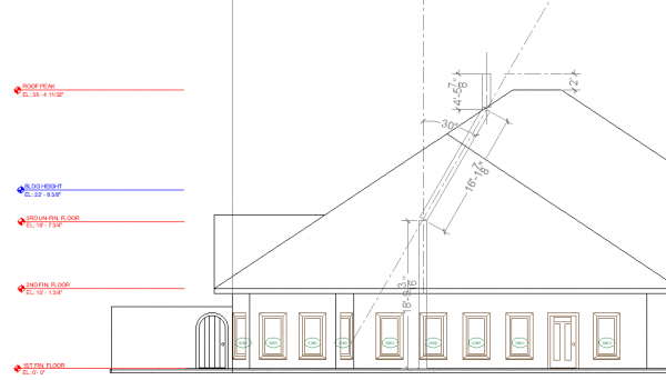

    New house, putting an Osburn Horizon in great room, 8" DuraTech flue, not centered in house EW although pretty close NS. High sloped roof with 8:12 pitch on a ~3 story house. The entire roof is insulated with R70+ so the conditioned space is everything under it. Top floor is not fully conditioned, but for this exercise we will assume it is. This means that if I don't slope the flue, then I would have about 8' of pipe sticking out above the penetration point of the roof to meet the 10:3:2 rule, or I can put a long slope in the flue and penetrate near the peak. Looking for some advice, would I be better to penetrate with a straight run and maybe incur stack affect, as well as a long external flue on the roof (which I can frame around), or to slope it and have issues with cleaning and lower draft. Image included of South elevation with sloped chimney.
    I don't think the lowered draft incurred by the slope would be too bad because of the overall height so I'm 'leaning' towards the sloped solution.

    I’d personally go straight up. Much easier to clean and inspect. Plus angled connections in triple wall stuff ain’t cheap...:makeitrain"

    The clean and inspect was my concern also, but straight up puts me 7'8" under the peak and needing an 8'+ flue sticking out of the roof. It also makes my penetration 8' lower than the highest heated space in the house. Not too worried about the cost differential, that's minor to the rest of the build and I figure my wife would make me build an external chase around it anyway, that cost would eclipse the extra flue from going up at an angle. I would assume there are clean out joints I can put in?

    Decided to go with the straight flue, got some local advice from a few chimney sweeps, they didn't think I would have any issues with the stack effect and therefore the vertical would be the way to go.
